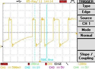

  • Hi Eyal,
    thank you for your advice. We are looking at the SDIO data lines and we observe that D3 has this ramp up behavior that we believe is causing our communication issues.
    I've attached an image showing this problem on the SDIO D3 and I hope that you are able to get some hardware engineer to comment on the possible cause of this issue.
    Also, we are using the TiWi01-R2 on our system while the Mistral daughter board have the TiWi01. Is there any problems if we are using a more updated TiWi IC with the Linux driver that clearly has been tested with the TiWi01?
    Hoping to hear some advise from your end.
  • Hi Eyal,
    Just want to get you across some updates on our debugging effort, we were able to eliminate the signal I've shown above by setting the TiWi to operate in 1.8V VIO and configuring the PIN as described by this document in the LSR WiKi http://wiki.lsr.com/GetFile.aspx?Page=TiWi&File=TiWi_R2_Pin_Table.xlsx
    Now after doing this we get a different console output that seems to go much further now but still will hang up the system.
    Below is the crash dump.
