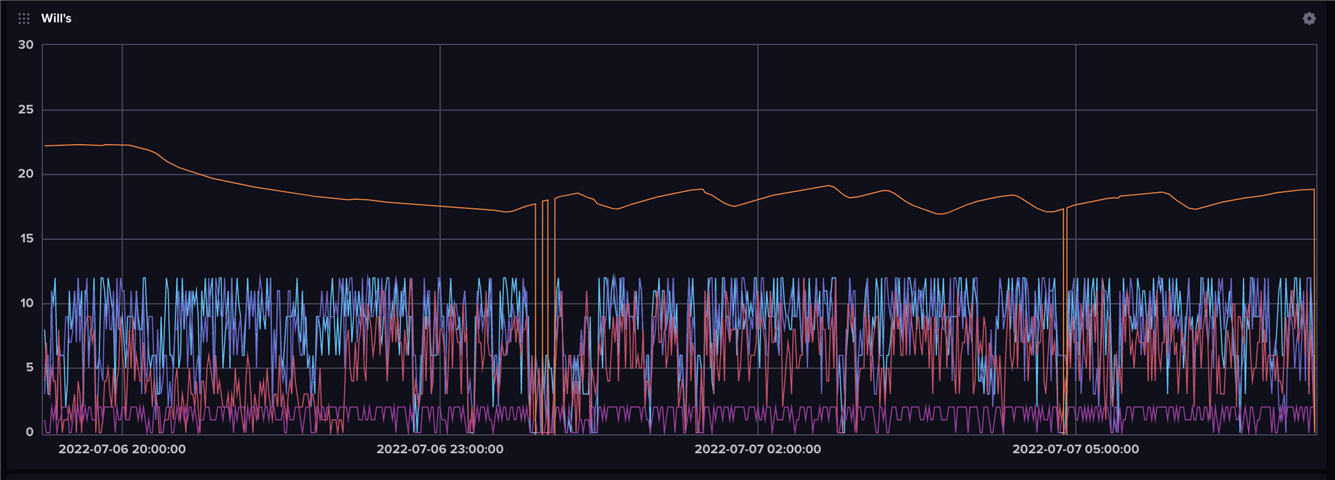

Hi, we are using the WL1837MOD in our Linux Armv7 based thermostat to scan for wireless BLE temperature sensors, which send a set of three advertisements (not connection oriented) every 15 seconds. The thermostat scans indefinitely with the maximum scan interval set via HCI and is connected to a wired power source, so the CPU never sleeps and the WL1837MOD never stops scanning. During testing, we have seen random periods of 5-10 minutes where other Bluetooth LE advertisements are seen by the WL1837MOD, but not our sensors. What makes this even more confusing, is the fact that in the same environment other Bluetooth hardware, including sniffers, do see the missing advertisement packets during the same period. This data, which was recompiled with hcidump, btmon, and a dedicated sniffer (based on the TI CC2400) indicates that either there is a hardware issue or more likely a firmware issue which filters the LE Advertisement events and never sends them via HCI to Linux.
We've tried long-running scans, and restarting the scan every 2 minutes. Sometimes we have sites that go days without consistent packet loss, other sites have multiple 5-minute gaps per day.  We have one environment at a engineer's house that consistently reproduces the problem multiple times a day. As far as signal strength, there appears to be no correlation to performance.  The second graph with just one color is the average signal strength for the three sensors.  Notice that the period of no data on the right is roughly indistinguishable from the center where's there's strong packet counts. Indeed, even on the left where the signal strength is relatively poor, we have good packet counts. We've also attempted to eliminate wifi co-existance as a contributing factor by disabling the wifi radio entirely and relying on ethernet for one test. This unit has the same patterns as devices with wifi active.
We're not using sleep mode of any kind on the processor, and we can see evidence of other BTLE packets being recieved during this time, but at much, much lower levels. I've attached that graph below as well. (It's using logarithmic scale, because the packet counts are substantially higher; you would be be able to see our sensors without it.)  Notice that the average packet count for the entire population of btle traffic is depressed during the period in question. However, it's worth noting that we're still receiving on the order of one thousand packets a second during this period. At this point, I don't see any explanation other than that they're going missing in the WL1937MOD itself.
Is there any way to dig deeper into the firmware of the WL1837MOD, or are there any known issues related to this that may be relevant?  At this point this problem is blocking a very important product release, and we're getting a lot of pressure to move forward.

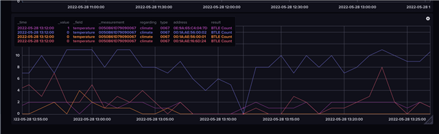

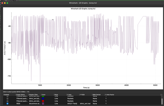

  • Hi Jacob, I work with Alsey, and I was able to capture an event.  (It's my lab that has a multiple-event-per-day rate).
    This event occurred on the 28th, and I was running the TI logger as well as btmon on the linux side.  Loading the btmon hci packets into wireshark reveals that the total packet count (not just our sensors) was significantly depressed, even going as low as a few hundred a minute (down from an average of 2500.
    Our logging system which is able to track the packets received from our sensors showed that the loss of packets was enough to bring the count from our sensors down to zero.  This would cause the thermostat to go into protection mode.
    13:12 local, 20:12 UTC
    0005.logs.ziphcidump.pcap.zip

  • Hi William and Alsey,
    Does the other Bluetooth hardware (like the sniffers you mention) capture these advertisements in addition to the thermostat advertisements? I'm trying to understand if these other advertisements are causing the WL1837 to drop the thermostat advertisements.

  • Thanks for starting to look at this Jacob!
    I'm not totally sure I follow, but I think the answer is that yes, the other hardware (including our older model that uses an atheros chipset) sees all thee advertisements.  In the period during this event:
    There was no change in packet counts on the atheros-based system.

  • All of sensors advertisements `oui` is `00:1a:ae` and the manufacturer data has our company ID, which you can filter with `btcommon.eir_ad.entry.company_id == 0x01d9`. We are sending Non-Connectable Undirected Advertising packets. Just to be clear, we periodically disable scanning and advertise on thermostats, then go back to scanning, but the outages we are seeing  are not advertising are during the scan intervals. We also have builds where the Thermostats only scan and the issue is present there. I tried alternating between scanning and adv to see if that helped, but its the same.
  • Hey Alsey,
    Thanks for the picture. I'll review your logs again to see if I can detect an issue.
    One workaround for you to prevent other non-sensor advertisements from being sent to your thermostat is to create an accept list. This allows the WL1837 to filter advertisements so that you only receive advertisements from the desired BLE temperature sensors. Perhaps this would help with the dropped advertisements from the temperature sensors.

  • Hi Jacob.  We've disabled wifi on one unit and let it sit for a week.  We compared its performance to another that had wifi enabled.  I've attached a screenshot of the influx data for the time period.  As before, these are packet counts per minute.  The upper trace is wifi disabled, and the lower is wifi enabled.  Notice that the wifi disabled case has a much tighter cluster of packet counts, and rarely goes to zero.  I checked each of the times it meets the origin, and counted the number of minutes that each gap lasts.  The longest is 4 minutes, and there are three such periods.  This isn't "desired", but it is acceptable for our use case.  The WiFi case, however has an almost uncountably large number of 5+ minute gaps.
    What are the next steps?  How can we work around the arbiter, and ensure that there's enough time scanning for BTLE packets?
    Thanks!
  • Hey William,
    I'll look to see if I can provide you more information on how the arbiter works - specifically with timing intervals. In the meantime, can you try adjusting the WL1837 BLE scan interval? Instead of scanning continuously, you could try different intervals of every 1 sec, 5 sec, 30 sec, etc. I think having this information in a table will be insightful for your application. I'm imagining something like this:
