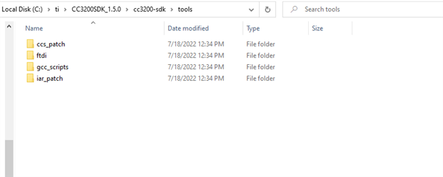

I'm currently starting to work on a project with CC3220SF simplelink board. Im following the instructions on the website but cannot find servicepack for the board anywhere in the sdk.
Latest SDK is installed but the cc32xx_tools subfolder does not exist for me
no other "tools" folder exists. I have been unable to manually find servicepack in any other folder.
Can you please tell us where can we find the missing files?

    I want to confirm you do have the correct SDK installed. Should be this one -> Link under Software Development.
    I can confirm the files are found in the SDK.
    This is the default file path
    C:\ti\simplelink_cc32xx_sdk_6_10_00_05\tools\cc32xx_tools\servicepack-cc3x20

  • Hi Danilo,
    You have wrong SDK installed. You have installed CC3200 SDK not a CC32xx SDK. Please install CC32xx SDK (6.10) from link at answer from Rogelio.
