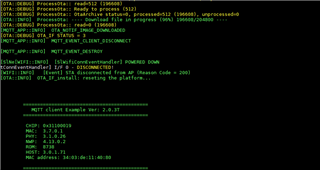

      I want to OTA by local http server. I use mqtt_client example  to test this  according https://dev.ti.com/tirex/explore/node?node=ACE5ggZRybEJNZUcnzc3ww__fc2e6sr__LATEST ,but use  local http server and directly download the file (using HTTP Get Request).
    I modify  mqtt_client example   code  as show to directly download file.
when  start ota ,the file was download and ota exe but device not run new firmware. The last log as show
In this log, i can't find any problem,what should i do?
  • It seems that the application (vers 2.0.3T) starts after the MCU reset.
    Is this the new image that you downloaded or the existing one?
    In the full log - do you find any issue? do you see the image being written successfully?
    Can you provide the full log?
  • Hi
        Thanks for reply!
        The ver 2.0.3T is existing firmware,and I want to ota to ver 2.0.3T-1.
       And the file is log file,please help to analyze,thanks !

    [MQTT_APP::INFO]  OTA_NOTIF_IMAGE_DOWNLOADED
    [OTA::DEBUG] OTA_IF STATUS = 3
    [MQTT_APP::INFO]  MQTT_EVENT_CLIENT_DISCONNECT
    [MQTT_APP::INFO]  MQTT_EVENT_DESTROY
    [SlNe[WIFI::INFO]  [SlWifiConnEventHandler] POWERED DOWN
    tConnEventHandler] I/F 0 - DISCONNECTED!
    [WIFI::INFO]   [Event] STA disconnected from AP (Reason Code = 200)
    [OTA::INFO]  OtaWatchDog: Watchdog is updated by mcubootinfo.bin from the OTA image
    [OTA::INFO]  OTA_IF_install: reseting the platform...

  • Everything seems fine in regards to the OTA process (mcuflashimg.bin seems to be updated). It can be an issue with the new image - if it get's stuck from some reason (as we don't even see the version display), the watchdog will perform a secondary reset and revert to the old image.
    Just to make sure all works well please add the OTA library logs. You will need to import the OTA project in CCS (under source/ti/net/ota), and enable (#define) SL_ENABLE_OTA_DEBUG_TRACES in "otauser.h" and rebuild the library. Then rebuild the app.
    BTW. I saw that you are also updating the "/sys/mcubootinfo.bin" - is this required? the watchdog timeout is already set. Can you try without this?
    Have you tried the new MCU Image without OTA (i.e. just by programming it)? If this works, please try adding the TAR file as a file in the file system and use the OTA's "INTERNAL_UPDATE_SUPPORT".
  • Compared with ver 2.0.3T, ver 2.0.3T-1 only modifies the version,and the ver V2.0.3T-1 can promgram and run.
    I test ota by internal mode,the ota is success.
    There are cloud_ota_log and internal_ota_log,I close watchdog and enbale SL_ENABLE_OTA_DEBUG_TRACES.
  • Log as show

    [OTA::DEBUG] ProcessOta:: read=0 (196608)
    [OTA::INFO]  OtaWatchDo[WIFI::INFO]   [Event] STA disconnected from AP (Reason Code = 200)
               MQTT client Example Ver: 2.0.3T

  • It seems that the server closed the connection before the TAR file was completely transferred,
    See line 881 in the cloud_ota log - the PrcoessOta reports read=0 (reading 0 bytes from receive() on a TCP socket means that the peer sent FIN to close the connection.
    Apparently the OTA_IF doesn't reports this as an error (theoretically an error could be reported since there are more bytes to read) and since the file (/sys/servicepack.ucf in this case) is not closed correctly, the entire OTA "bundle" is being invalidated.
    We will be able to verify this with an air sniffer, but i would check the server for any size limitation.
  • OK  ,this problem by fenix http server.
    I create apach http server in ubuntu,ota is success.
