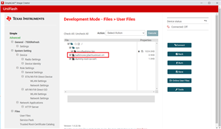

  • I downloaded "BaltimoreCyberTrustRoot.crt" in flash memory of CC3235SF LAUNCH Pad using Uniflash tool in user files section.
    I updated MQTT client example application and provided name of this file as shown below in mqtt_client_app.c file:
    char *Mqtt_Client_secure_files[CLIENT_NUM_SECURE_FILES] = {"BaltimoreCyberTrustRoot.crt"};

  • It means that the root ca is not included in the certificate catalog. I guess you are using the "playground" catalog and not the official one because the official contains "Baltimore CyberTrust Root". One option is to switch to that one (then you will need a valid root ca to install the mcu image).
    Other option are to ignore this error (connection will still be opened when -468 is returned) or to disable it with sl_SetSockOpt (SL_SO_SECURE_DISABLE_CERTIFICATE_STORE).
    Using the mqttclient API you can set the MQTTCLIENT_NETCONN_SKIP_CERTIFICATE_CATALOG_VERIFICATION.

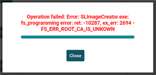

    In Uniflash, I noticed that I have not checked "Use default Trusted Root-Certificate Catalog" check box and hence it was using 'playground' catalog. Now I have checked this checkbox. But it gives error while flashing the image and root certificate catalog:
  • -461 means SL_ERROR_BSD_ESECDATEERROR (see simplelink/errors.h) that connection failed because the date of the certificate is not valid.

    regarding the uniflash issue: If you move to official catalog - you can't use the playground certificates anymore - you will need to use a certificate that was signed by a valid root ca that is included in the catalog.
