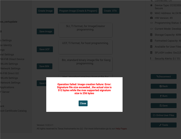

We have an application with an OTA mechanism implemented. Since our current code signing certificate is about to expire, we have requested a new.
Our certificate authority does not support the SHA 256 key size anymore and supplied a new 512 key size.
This new key trow an error in our OTA application, we tracked this down to the sl_FsClose function.
When using our new key the function returns -10290
#define SL_ERROR_FS_WRONG_SIGNATURE_OR_CERTIFIC_NAME_LENGTH             (-10290L)
If we check the Simplelink WiFi Network processor user guide we find on page 138 chapter 8.4.7 there is noted that the device supports up to 512 certificate chain verification type.
https://www.ti.com/lit/ug/swru455m/swru455m.pdf?ts=1665048047843

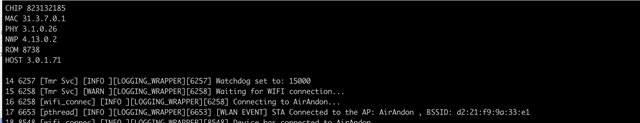

Another test we did, is that we flashed the device with an image, signed with the old certificate, containing the necessary files to support the new certificate.  But we still getting the sl_FsCl.ose error after performing an OTA.
When we try to flash the device using Uniflash we get the error below:
We tested both ways (OTA and Uniflash) with sp_4.8.0.8_3.7.0.1_3.1.0.26, and sp_4.13.0.2_3.7.0.1_3.1.0.26
  • The uniflash (i.e. programming) would fail since the ROM bootloader doesn't support the longer keys.
    It requires installing SP to get the 512B support.
    The OTA should work assuming the certificate used for verification was updated (and the SP is installed).
  • We did a new test to use our new code signing certificate following the steps below:
    1) Made a new image, signed with the old certificate.  This image contains all the new cert files.
    2) We flashed this image to the device using uniflash.
    3) On boot the device prints out the files it contains, just to check if all necessary files are in place:

    Our old certificate is the application_cert, and our new is the "application_cert_2024_12_16", "digicert assured id root ca" and "digicert sha2 assured id code signing ca"
    4) Also the version of the installed SP is printed out to check if we have the most recent version running:
    4) When the device was running and connected, we send out an OTA, signed with the new certificate.

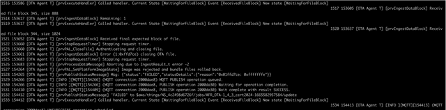

    5) When the new image file is received, the file is checked, and here fails the device:
    The error message is:   "Error (!:0xffd7ce) closing OTA file.
    If we follow this message in the source we find it fails on the fs_Close() function:

    We did the same test as above, but this time we captured the NWP logs from boot, over OTA until it failed.  I embedded the log below:
    ���Đ���������������D�@�@@ ����Ċ��������C$����T���,��ȴ��E����J�Đ�J�$����?������~�����
                                                                                        ���������#����\�J,��,���K)ۿ^��B��<����������@����t����5��������������������|_q��`����������������������B����`���������<�����������xKx�oZp6E�|�r��w����~�����|������kA��������������������������R��^4�,���������O<�64��:��0��6�~��>����M�ZF����~�� Xf�`���������������������������������`�������������\������X`��
                                              ���� ��������������������������������������������������������������������������������������������������������������������Q�������������������������������������������������������#@�����������������������������(�����������������������������������������������������������������������������p�������������@������������������������������������������������������ ����������������������������������������������0����������������������������������������������������������������������������(�����������0�������������������������v������������������������������������������� ���������������������������������������������������������������������������������������������
    Below the UART output when the OTA failed:
    Agent T] [prvIngestDataBlock] Received file block 345, size 888
    1586 155928 [OTA Agent T] [prvIngestDataBlock] Received final expected block of file.
    1587 155936 [OTA Agent T] [prvStopRequestTimer] Stopping request timer.
    1588 155936 [OTA Agent T] [prvPAL_CloseFile] Authenticating and closing file.
    1589 155937 [OTA Agent T] [prvIngestDataBlock] Error (1:0xffd7ce) closing OTA file.
    1590 155959 [OTA Agent T] [prvStopRequestTimer] Stopping request timer.
    1591 155959 [OTA Agent T] [prvProcessDataMessage] Aborting due to IngestResult_t error -2
    1592 156538 [OTA Agent T] [prvPAL_SetPlatformImageState] Image was rejected and bundle files rolled back.
    1593 156538 [OTA Agent T] [prvPublishStatusMessage] Msg: {"status":"FAILED","statusDetails":{"reason":"0x01ffd7ce: 0xfffffffe"}}
    1594 156539 [OTA Agent T] [INFO ][MQTT][156539] (MQTT connection 2000da88) MQTT PUBLISH operation queued.
    1595 156540 [OTA Agent T] [INFO ][MQTT][156539] (MQTT connection 2000da88, PUBLISH operation 2000dcc0) Waiting for operation completion.
    1596 156703 [OTA Agent T] [INFO ][MQTT][156701] (MQTT connection 2000da88, PUBLISH operation 2000dcc0) Wait complete with result SUCCESS.
    1597 156704 [OTA Agent T] [prvPublishStatusMessage] 'FAILED' to $aws/things/NS_4c2498d6726f/jobs/AFR_OTA-1_4_3_cert2024-1665736938191/update
    To point out the error we get (-10290) is not from our certificate name length, we tried to shorten our cert name lengt from application_cert_20221216 tot app_cert, but this did not help either.

  • Kobi,
    The data before was just copied from the screen terminal in MAC.
    The log below is the raw log file from putty.exe, as described in the datasheet.  Hope this works now.
      CC3235SF_OTA_20221020_141535.log
  • This one is ok. Thanks.
    What i just learned, is that the secure file signature can't be more 256B. The support of 512B is for the chain itself. So you can use a chain that internally includes a 512B signatures, but when you generate you own private key and CSR - it should include a shorter key so the image signature will be up to 256B.
  • Hey Kobi. Can this be supported via a service pack update or is this a hardware limitation? We use a code signing certificate from DigiCert and they have changed their policy about code signing certificates. As of the end of May, DigiCert will no longer allow you to generate code signing certificates smaller than 3072 key size.https://knowledge.digicert.com/alerts/code-signing-new-minimum-rsa-keysize.html
  • Theoretically this can be fixed by a service pack. I'll need to double check if there are any limitations there.
    The hardware limits from using key > 2048b in production (i.e. before the first SP is loaded). and since this was the main issue for our customers we recommended them to program their own catalog (see https://www.ti.com/lit/pdf/swru547) and use a self-signed keys.
    Since a service pack can (theoretically) solve your use-case, i'll raise the requirement for the next SDK release.
    I'll update here when i have more info.
  • BTW. What is the reason you need to create a new certificate?  can't you  just use your old certificate for that?
    (during the code signature verification we are not checking date validity).
  • We are using the same certificate to initial flash the devices and to perform OTAs. We are still in the process of rolling out new devices. If I remember correctly, the expire date of the certificate is validated when flashing the device with Uniflash. That is the reason we we need to update/replace our certificate.
  • The expiration date is not checked for code signature verification (only during TLS).
    You can use your existing certificate.
