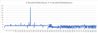

  • Hi Rogleio,
    I got further feedback/questions:
    Did you mean the HCI_VS_Configure_DDIP (0xFD55) command, which is described in chapter 4.1.1.9 in this document?
    https://www.ti.com/lit/ug/swru442b/swru442b.pdf
    The commands description states:
    This command configures the bandwidth allocation between ACL (best effort or guaranteed connection)
    and Inquiry/Page/Bluetooth low energy scans. …
    The command does not have a parameter for a connection handle, so I assume it does configure bandwidth allocation in general. As it has two parameters for ACL percentage for best effort ACL and guaranteed ACL during page/inquiry/low energy scans, I understand that the command does configure the percentage of both best effort ACL and guaranteed ACL vs page/inquiry/low energy scans.
    I cannot find anything about switching the connection type between best effort and guaranteed.
    In contrast the HCI_Flow_Specification and the HCI_QoS_Setup both support to specify a service type, being best effort or guaranteed, for a connection (however I get a QoS not supported replay whenever I try to set the service type to guaranteed, as written before).
    Could you confirm that I understood the meaning of these commands correctly?
    I also applied the HCI_Write_Scan_Enable command with parameter 0 to make sure that there is no page/inquire scan activity (no effect on the latency).
    Same about HCI_LE_Set_Scan_Enable – there was no effect neither.

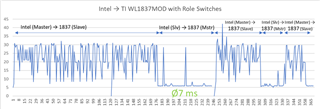

    In order to check, that no other Bluetooth devices do have any influence, I performed the measurement inside an EMC chamber (= faraday cage) with no other wireless devices being active:
    I got the exact same result as before, that the L2CAP echo takes between 5 and 30 ms with an average of over 20 milliseconds.
    A new observation is, that the delay until the Number of Completed Packets Event does change, when I perform a role change.
    The Bluetooth devices having the master role, has a delay of 3 to 4 milliseconds from a L2CAP packet being sent until the Number of Completed Packets event is received. But the slave device has a delay varying between 5 and 27 milliseconds.
    And there is no other connection beside the one used for L2CAP echo measurements.
    I know that a Bluetooth slave is not able to send data at any time. But a delay of about 20 milliseconds with only 1 connection and no scan activity seems to be far to high.

    Attachments: https://e2e.ti.com/cfs-file/__key/communityserver-discussions-components-files/968/l2ping1_5F00_echo.btsnoop

    44 bytes from 74:E1:82:2C:90:63 id 0 time 29.67ms
    44 bytes from 74:E1:82:2C:90:63 id 1 time 22.13ms
    44 bytes from 74:E1:82:2C:90:63 id 2 time 8.41ms
    44 bytes from 74:E1:82:2C:90:63 id 3 time 30.94ms
    44 bytes from 74:E1:82:2C:90:63 id 4 time 27.36ms
    44 bytes from 74:E1:82:2C:90:63 id 5 time 29.36ms
    44 bytes from 74:E1:82:2C:90:63 id 6 time 20.88ms
    44 bytes from 74:E1:82:2C:90:63 id 7 time 8.40ms
    44 bytes from 74:E1:82:2C:90:63 id 8 time 30.93ms
    44 bytes from 74:E1:82:2C:90:63 id 9 time 28.40ms
    44 bytes from 74:E1:82:2C:90:63 id 10 time 29.73ms
    44 bytes from 74:E1:82:2C:90:63 id 11 time 20.86ms
    44 bytes from 74:E1:82:2C:90:63 id 12 time 8.49ms
    44 bytes from 74:E1:82:2C:90:63 id 13 time 29.41ms
    44 bytes from 74:E1:82:2C:90:63 id 14 time 29.65ms
    44 bytes from 74:E1:82:2C:90:63 id 15 time 29.65ms
    44 bytes from 74:E1:82:2C:90:63 id 16 time 14.66ms
    44 bytes from 74:E1:82:2C:90:63 id 17 time 19.60ms
    44 bytes from 74:E1:82:2C:90:63 id 18 time 25.91ms
    44 bytes from 74:E1:82:2C:90:63 id 19 time 30.81ms
    44 bytes from 74:E1:82:2C:90:63 id 20 time 27.17ms
    44 bytes from 74:E1:82:2C:90:63 id 21 time 20.91ms
    44 bytes from 74:E1:82:2C:90:63 id 22 time 8.47ms
    44 bytes from 74:E1:82:2C:90:63 id 23 time 29.85ms
    44 bytes from 74:E1:82:2C:90:63 id 24 time 29.36ms
    44 bytes from 74:E1:82:2C:90:63 id 25 time 29.08ms
    44 bytes from 74:E1:82:2C:90:63 id 26 time 22.39ms
    44 bytes from 74:E1:82:2C:90:63 id 27 time 8.42ms
    44 bytes from 74:E1:82:2C:90:63 id 28 time 28.39ms
    44 bytes from 74:E1:82:2C:90:63 id 29 time 29.60ms
    44 bytes from 74:E1:82:2C:90:63 id 30 time 29.62ms
    44 bytes from 74:E1:82:2C:90:63 id 31 time 20.92ms
    44 bytes from 74:E1:82:2C:90:63 id 32 time 9.58ms
    44 bytes from 74:E1:82:2C:90:63 id 33 time 28.49ms
    44 bytes from 74:E1:82:2C:90:63 id 34 time 30.86ms
    44 bytes from 74:E1:82:2C:90:63 id 35 time 30.83ms
    44 bytes from 74:E1:82:2C:90:63 id 36 time 19.62ms
    44 bytes from 74:E1:82:2C:90:63 id 37 time 7.16ms
    44 bytes from 74:E1:82:2C:90:63 id 38 time 14.64ms
    44 bytes from 74:E1:82:2C:90:63 id 39 time 22.12ms
    44 bytes from 74:E1:82:2C:90:63 id 40 time 26.99ms
    44 bytes from 74:E1:82:2C:90:63 id 41 time 21.16ms
    44 bytes from 74:E1:82:2C:90:63 id 42 time 8.34ms
    44 bytes from 74:E1:82:2C:90:63 id 43 time 30.90ms
    44 bytes from 74:E1:82:2C:90:63 id 44 time 28.45ms
    44 bytes from 74:E1:82:2C:90:63 id 45 time 29.56ms
    44 bytes from 74:E1:82:2C:90:63 id 46 time 22.15ms
    44 bytes from 74:E1:82:2C:90:63 id 47 time 8.36ms
    44 bytes from 74:E1:82:2C:90:63 id 48 time 29.68ms
    44 bytes from 74:E1:82:2C:90:63 id 49 time 28.36ms
    44 bytes from 74:E1:82:2C:90:63 id 50 time 29.59ms
    44 bytes from 74:E1:82:2C:90:63 id 51 time 20.83ms
    44 bytes from 74:E1:82:2C:90:63 id 52 time 29.58ms
    44 bytes from 74:E1:82:2C:90:63 id 53 time 8.45ms
    44 bytes from 74:E1:82:2C:90:63 id 54 time 29.63ms
    44 bytes from 74:E1:82:2C:90:63 id 1 time 22.09ms
    44 bytes from 74:E1:82:2C:90:63 id 2 time 9.63ms
    44 bytes from 74:E1:82:2C:90:63 id 3 time 27.23ms
    44 bytes from 74:E1:82:2C:90:63 id 4 time 30.89ms
    44 bytes from 74:E1:82:2C:90:63 id 5 time 28.39ms
    44 bytes from 74:E1:82:2C:90:63 id 7 time 8.43ms
    44 bytes from 74:E1:82:2C:90:63 id 8 time 29.69ms
    44 bytes from 74:E1:82:2C:90:63 id 9 time 13.43ms
    Send failed: Connection reset by peer
    mon # l2ping -i hci1 74:E1:82:2C:90:63
    Ping: 74:E1:82:2C:90:63 from C8:DF:84:4E:4F:D5 (data size 44) ...
    44 bytes from 74:E1:82:2C:90:63 id 0 time 4.51ms
    44 bytes from 74:E1:82:2C:90:63 id 1 time 22.26ms
    44 bytes from 74:E1:82:2C:90:63 id 2 time 30.89ms
    44 bytes from 74:E1:82:2C:90:63 id 3 time 20.89ms
    44 bytes from 74:E1:82:2C:90:63 id 4 time 19.67ms
    44 bytes from 74:E1:82:2C:90:63 id 5 time 33.50ms
    44 bytes from 74:E1:82:2C:90:63 id 6 time 29.64ms
    44 bytes from 74:E1:82:2C:90:63 id 7 time 9.65ms
    44 bytes from 74:E1:82:2C:90:63 id 8 time 22.23ms
    44 bytes from 74:E1:82:2C:90:63 id 9 time 24.50ms
    44 bytes from 74:E1:82:2C:90:63 id 10 time 32.26ms
    44 bytes from 74:E1:82:2C:90:63 id 11 time 17.05ms
    44 bytes from 74:E1:82:2C:90:63 id 12 time 29.70ms
    44 bytes from 74:E1:82:2C:90:63 id 13 time 34.71ms
    44 bytes from 74:E1:82:2C:90:63 id 14 time 29.68ms
    44 bytes from 74:E1:82:2C:90:63 id 15 time 10.86ms
    44 bytes from 74:E1:82:2C:90:63 id 16 time 17.21ms
    44 bytes from 74:E1:82:2C:90:63 id 17 time 7.17ms
    44 bytes from 74:E1:82:2C:90:63 id 18 time 26.97ms
    44 bytes from 74:E1:82:2C:90:63 id 19 time 29.88ms
    44 bytes from 74:E1:82:2C:90:63 id 20 time 33.54ms
    44 bytes from 74:E1:82:2C:90:63 id 21 time 17.01ms
    44 bytes from 74:E1:82:2C:90:63 id 22 time 28.44ms
    44 bytes from 74:E1:82:2C:90:63 id 23 time 19.68ms
    44 bytes from 74:E1:82:2C:90:63 id 24 time 19.66ms
    44 bytes from 74:E1:82:2C:90:63 id 25 time 34.60ms
    44 bytes from 74:E1:82:2C:90:63 id 26 time 17.15ms
    44 bytes from 74:E1:82:2C:90:63 id 27 time 9.77ms
    44 bytes from 74:E1:82:2C:90:63 id 28 time 28.45ms
    44 bytes from 74:E1:82:2C:90:63 id 29 time 28.39ms
    44 bytes from 74:E1:82:2C:90:63 id 30 time 33.54ms
    44 bytes from 74:E1:82:2C:90:63 id 31 time 15.78ms
    44 bytes from 74:E1:82:2C:90:63 id 32 time 29.69ms
    44 bytes from 74:E1:82:2C:90:63 id 33 time 22.25ms
    44 bytes from 74:E1:82:2C:90:63 id 34 time 19.50ms
    44 bytes from 74:E1:82:2C:90:63 id 35 time 30.90ms
    44 bytes from 74:E1:82:2C:90:63 id 36 time 17.05ms
    44 bytes from 74:E1:82:2C:90:63 id 37 time 29.67ms
    44 bytes from 74:E1:82:2C:90:63 id 38 time 33.53ms
    44 bytes from 74:E1:82:2C:90:63 id 39 time 30.91ms
    44 bytes from 74:E1:82:2C:90:63 id 40 time 33.39ms
    44 bytes from 74:E1:82:2C:90:63 id 41 time 25.89ms
    44 bytes from 74:E1:82:2C:90:63 id 42 time 19.71ms
    44 bytes from 74:E1:82:2C:90:63 id 43 time 33.47ms
    44 bytes from 74:E1:82:2C:90:63 id 44 time 29.65ms
    44 bytes from 74:E1:82:2C:90:63 id 45 time 33.52ms
    44 bytes from 74:E1:82:2C:90:63 id 46 time 25.89ms
    44 bytes from 74:E1:82:2C:90:63 id 47 time 22.06ms
    44 bytes from 74:E1:82:2C:90:63 id 48 time 33.46ms
    44 bytes from 74:E1:82:2C:90:63 id 49 time 28.34ms
    44 bytes from 74:E1:82:2C:90:63 id 50 time 33.40ms
    44 bytes from 74:E1:82:2C:90:63 id 51 time 25.87ms
    44 bytes from 74:E1:82:2C:90:63 id 52 time 20.88ms
    44 bytes from 74:E1:82:2C:90:63 id 53 time 9.65ms
    44 bytes from 74:E1:82:2C:90:63 id 54 time 28.38ms
    44 bytes from 74:E1:82:2C:90:63 id 0 time 33.38ms
    44 bytes from 74:E1:82:2C:90:63 id 1 time 25.89ms
    44 bytes from 74:E1:82:2C:90:63 id 2 time 19.67ms
    44 bytes from 74:E1:82:2C:90:63 id 3 time 19.69ms
    44 bytes from 74:E1:82:2C:90:63 id 4 time 20.89ms
    44 bytes from 74:E1:82:2C:90:63 id 5 time 32.15ms
    44 bytes from 74:E1:82:2C:90:63 id 6 time 25.85ms
    44 bytes from 74:E1:82:2C:90:63 id 7 time 20.92ms
    44 bytes from 74:E1:82:2C:90:63 id 8 time 8.33ms
    44 bytes from 74:E1:82:2C:90:63 id 9 time 8.50ms
    44 bytes from 74:E1:82:2C:90:63 id 10 time 29.65ms
    44 bytes from 74:E1:82:2C:90:63 id 11 time 25.75ms
    44 bytes from 74:E1:82:2C:90:63 id 12 time 19.67ms
    44 bytes from 74:E1:82:2C:90:63 id 13 time 34.80ms
    44 bytes from 74:E1:82:2C:90:63 id 14 time 13.41ms
    44 bytes from 74:E1:82:2C:90:63 id 15 time 25.97ms
    44 bytes from 74:E1:82:2C:90:63 id 16 time 24.62ms
    44 bytes from 74:E1:82:2C:90:63 id 17 time 20.97ms
    44 bytes from 74:E1:82:2C:90:63 id 18 time 33.52ms
    44 bytes from 74:E1:82:2C:90:63 id 19 time 25.93ms
    44 bytes from 74:E1:82:2C:90:63 id 20 time 12.34ms
    44 bytes from 74:E1:82:2C:90:63 id 21 time 25.84ms
    44 bytes from 74:E1:82:2C:90:63 id 22 time 21.01ms
    44 bytes from 74:E1:82:2C:90:63 id 23 time 34.63ms
    44 bytes from 74:E1:82:2C:90:63 id 24 time 28.32ms
    44 bytes from 74:E1:82:2C:90:63 id 25 time 34.70ms
    44 bytes from 74:E1:82:2C:90:63 id 26 time 25.94ms
    44 bytes from 74:E1:82:2C:90:63 id 27 time 19.68ms
    44 bytes from 74:E1:82:2C:90:63 id 28 time 33.50ms
    44 bytes from 74:E1:82:2C:90:63 id 29 time 29.62ms
    44 bytes from 74:E1:82:2C:90:63 id 31 time 25.85ms
    44 bytes from 74:E1:82:2C:90:63 id 32 time 20.94ms
    44 bytes from 74:E1:82:2C:90:63 id 33 time 27.15ms
    44 bytes from 74:E1:82:2C:90:63 id 34 time 19.69ms
    44 bytes from 74:E1:82:2C:90:63 id 35 time 25.90ms
    44 bytes from 74:E1:82:2C:90:63 id 36 time 24.79ms
    44 bytes from 74:E1:82:2C:90:63 id 37 time 19.74ms
    44 bytes from 74:E1:82:2C:90:63 id 38 time 19.67ms
    44 bytes from 74:E1:82:2C:90:63 id 39 time 19.60ms
    44 bytes from 74:E1:82:2C:90:63 id 40 time 33.49ms
    44 bytes from 74:E1:82:2C:90:63 id 41 time 25.77ms
    44 bytes from 74:E1:82:2C:90:63 id 42 time 20.88ms
    44 bytes from 74:E1:82:2C:90:63 id 43 time 33.19ms
    44 bytes from 74:E1:82:2C:90:63 id 44 time 29.88ms
    44 bytes from 74:E1:82:2C:90:63 id 45 time 33.35ms
    44 bytes from 74:E1:82:2C:90:63 id 46 time 25.96ms
    44 bytes from 74:E1:82:2C:90:63 id 47 time 19.64ms
    44 bytes from 74:E1:82:2C:90:63 id 48 time 19.68ms
    44 bytes from 74:E1:82:2C:90:63 id 49 time 22.00ms
    44 bytes from 74:E1:82:2C:90:63 id 50 time 32.17ms
    44 bytes from 74:E1:82:2C:90:63 id 51 time 25.88ms
    44 bytes from 74:E1:82:2C:90:63 id 52 time 19.62ms
    44 bytes from 74:E1:82:2C:90:63 id 53 time 33.25ms
    44 bytes from 74:E1:82:2C:90:63 id 54 time 29.94ms
    44 bytes from 74:E1:82:2C:90:63 id 0 time 33.42ms
    44 bytes from 74:E1:82:2C:90:63 id 1 time 25.88ms
    44 bytes from 74:E1:82:2C:90:63 id 2 time 22.07ms
    44 bytes from 74:E1:82:2C:90:63 id 3 time 33.41ms
    44 bytes from 74:E1:82:2C:90:63 id 4 time 28.36ms
    44 bytes from 74:E1:82:2C:90:63 id 5 time 33.39ms
    44 bytes from 74:E1:82:2C:90:63 id 6 time 25.92ms
    44 bytes from 74:E1:82:2C:90:63 id 7 time 20.86ms

    I got further feedback from the customer. There is some success when WL18x talks to another BT device, but no success between WL18x devices:
    On our side I have carried out a series of further tests, but unfortunately I have not yet achieved a breakthrough, but rather a confusing/worrying result. We have not been successful in getting the Bluetopia stack up and running.
    We did get ready BeagleBone blue boards on which the TI WL1835MOD is populated so we can do independent testing . I was able to recreate the exact same behavior with this board , so the more I understand that the issue is within the TI Bluetooth module firmware and not within the operating system.
    In addition, we performed a number of tests directly on the HCI interface to eliminate the Bluetooth stack as a source of error.
    Finally, I made some progress in configuring the Bluetooth communication quality of service. This has enabled me to get an average latency of 8 ms (L2CAP echo request/response with 10% output in the range of 25 ms) – we would be completely satisfied with a latency of less than 15 ms.
    However, this works with only a TI WL1837MOD and another Bluetooth module. As soon as I have a connection between 2 TI WL1837MOD modules, I get the Quality of Service configuration confirmed, but the latency remains 25 to 30 ms.
    I have to make further attempts here.
    The results were much more confusing when it came to investigating the latency between different Bluetooth modules.
    Although the TI WL1837MOD part had connections with just under 30 ms latency, with virtually no outlier. Sometimes the latency changes, though, is short in the range of 8 ms and then again at 30 ms.
    Depending on the attempt, I get different patterns in latency, although here I only repeat the same command that establishes a connection and measures the latency using L2CAP echo:
    This experiment has turned out to be much more extreme between the TI WL1337MOD and an Intel Bluetooth module.
    There I also performed a master-slave switch during the existing connection, which has understandably changed the latency pattern.
    But depending on which module is used to build the initial connection, the latency and oscillation of the latency is extremely different.
    It's the TI Bluetooth module, where I can see these vibrations repeatedly in different combinations with other Bluetooth modules, while the connections between the other Bluetooth modules almost always have a constant latency with few trips.
    With one way to record the commands at the level of the Link Manager protocol of a Bluetooth connection, I could not detect any significant differences between the modules, the connection process continues to be identical.
    At the moment, I cannot explain where the vibrations or the large outliers come from and why they are so extreme.
    But this is just a minor issue, but hopefully it will show you how difficult the investigations are.
