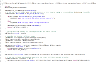

  • Hello Jonathan. I and Jiri were looking for the more elegant workaround to avoid recreation of MQTT client after possible disconnection, however I also have not managed to find better solution than recreate MQTT client again after each disconnection (that is what we are doing in our application). I have tried the same approach as Jiri mentioned and would like to confirm result of his investigation. Precondition is that our devise is not allowed to connect to the broker (IOT hub connection is disabled like on the screen attached above). Here is a sequence of actions in our application:
    1) call to MQTT_create() returns 0 which is expected;
    2) create MQTT context thread. MQTTClient_run(0) is called from that thread;
    3) set parameters with MQTTClient_set(): MQTTClient_USER_NAME, MQTTClient_CLEAN_CONNECT = true
    4) call to MQTTClient_connect(). First time -3 (MQTT_PACKET_ERR_NET_OPS) is returned, all next calls to this function return -0.
    I also noticed that MQTTClient_run(0) function terminates immediately on step 4 (after MQTTClient_connect() returns -3). I also tried to perform step 2 before each call to MQTTClient_connect(), but every next call to MQTTClient_connect() terminates with error code 0, although I expected -3 either.
    Then I downloaded SDK v 6.10.00.05 and looked at "mqtt_client" demo example. At this point I decided to keep our sours code as it is because in the example, MQTT client is also recreated after every disconnection and this is probably correct use of MQTT library:

  • I think you are right. The Create and Connect (as well as the MQTT context thread) are tight together, thus the fix is the recommended behavior.
    I will still need to check why the "MQTTClient_connect" returns 0 when there is no active MQTTClient_run. I'll update as soon as i find anything.

    I was not able to reproduce the issue where "MQTTClient_connect" returns 0 (I'm using SDK6.10).
    Is it still an issue when binding the _create and _connect together?
  • Hi Kobi,
    I was just waiting for some info that was promised. If the problem is not reproduced on your side, we can close this topic. We are using SDK v5.10.00.02.
    I will ask Ihor if he has something to add.
    Regarding binding the _create and _connect together - I would say it is not real issue, it is just not obvious that this is needed. Not a regular practice.
    Jiří
  • I also don't like this binding either, thus the MQTT_IF module tries to simplify the interface for the app developer.
