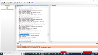

  • Hi Jessica,
    The video file displays a failure to open the BLE fixed frequency tool .
  • What I can observe from your video is that when you open the "HCI tester" tool it did not find the device at the selected com port. You should click the icon on the top bar to "configure connections" (see image below), and make sure to select the correct com port where the device is connected. (You may use Windows "Device manager" to observe which com port number appears when you connect the usb cable)
    For BT testing using the HCI Tester Tool is correct, and the HCI Commands User's Guide is here.   I recommend you review section 1.2 "Configuration Requirements" which explains what files you need that should be found in your "wl18xx_bt_sp_v4.8" zip file.

  • First have you been able to verify that the HCITester tool and your WL8 device are communicating after choosing the correct com port?
    If not I recommend you find the HCI_VS_Get_Sytem_Status command under the HCI VS commands. (You can refer to section "4.3.2.1 Searching for a Specific Command in the Command Library" to find it quicker)
    This HCI_VS_Get_System_Status (0xFE1F) command can be used to verify that there is good communication when the device is connected. After the command is sent once, check that the trace window has message similar to the image below:
    Most importantly make sure that before running your script that you initialize the board with the modified BTS script. As mentioned in section 3.2 you must replace the "5000, 0x00" with "5000, any" then save that script as a new initialization file in .txt format. Example below:
    AFTER you have run the initialization script you can send other commands or run a new script with your desired HCI commands, but the modified initialization script must be successfully run first.

  • Hi Colin,
    First could you confirm that you sent the "Get_System_Status" command once? To send the command make sure to double click on the command once, the command should not need to be run in a script.  I recommend you add this command to "my shortcuts" for ease of use (see 4.3.2.2 "Executing a Single Command" in the HCITester Tool User Guide, Lit# SWRU136). See image below:
    As mentioned in section 3.2 of the HCI Tester Guide have you replaced ALL the "5000, 0x00" with  "5000, any" then saved that script as a new initialization file in .txt format? Once you have done that running the initialization script once will download the FW and in general initialize the module.
    Let me know if you have more issues or questions on the matter.

  • Hi Jessica,what should i do if the device without reply any message after i send the command "get system status"?
  • Hi Collin,
    Could you run the same command but make sure you are connected to the device using the BT_HCI_RX and  BT_HCI_TX pins (53 and 52 respectfully) ?

  • Hi Jessica,
    Thanks for your support. Finally the HCI tester was able to talk to the WL module. Attachment is the result. Please advise what Colin needs to do next.
    0221 Script log.txt0221 Trace log.txt0221bt4.2.txthttps://e2e.ti.com/cfs-file/__key/communityserver-discussions-components-files/968/TIInit_5F00_11.8.32BT4.2.bts
    Kien Nguyen
  • It seems you have been able to confirm that the device is communicating by running the "HCI_VS_Get_System_Status" command, which is great!  Although it seems they tried to run the the TIInit_11.8.32BT4.2.txt file (saved as "0221 Script log.txt" for the customer it seems) unsuccessfully?
    Try successfully running the attached INI file :
     3252.TIInit_11.8.32.txt
    Once the Initialization Script has been successfully run they can use separate HCI commands on the device (see Section4.3.2.2 Executing a Single Command of the HCI Tester UserGuide) or run a new script with the desired HCI commands (see WiLinkTm 8.0 Bluetooth® Vendor-Specific HCI Command ).

  • Hi Jessica,
    • The test is ready to begin normally.
