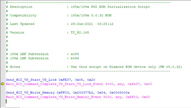

  • I'm trying to setup HCITester for Bluetooth regulatory testing, but run into a timeout error immediately after I execute the BTS file.
  • I already edited the BTS code as instructed in the HCI user guide: "Replace the “0x00” value in the “Number of HCI Commands” parameter to “any”.
  • I'm currently running an embedded Linux platform, and I transferred the BTS file (TIInit_11.8.32.bts) to /lib/firmware on my device as instructed.
  • The device is connected via serial port.

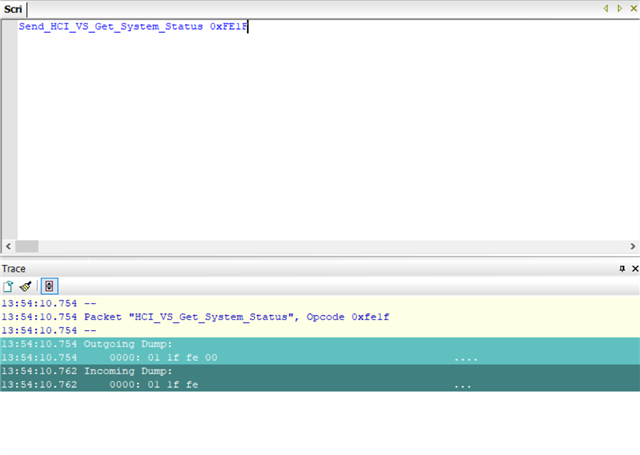

    Are you failing on both, HCITester and Linux platform?
    With HCITester, are you able to connect to the COM port and send a command before loading the BTS script?
    For example, if you run "Send_HCI_VS_Get_System_Status 0xFE1F"

    Here's a screenshot after running Send_HCI_VS_Get_System_Status 0xFE1F
    Here's a screenshot when I run the BTS script:
    BTS Script failing:

    Seems to me like the BT_EN is not asserted so the BT section in the chip is powered off.
    Regardless, the UART should use hardware flow control and you have it set to None.
    Have you made sure it is on?
    Not clear from the thread whether you have it working via Linux. Please clarify?

    TIInit_11.8.32.bts is enough as the other one is for BT4.2 only. Should be located under /lib/firmware/ti-connectivity. No other file is required.
    If you use 115200 baud rate, you don't need to make any modifications to the bts file. However, if you want to increase to 3Mbps, you will need to add a command at the beginning of the bts file to set the baud rate in the BT controller, but let's start with the default 115200 and see how it goes.
