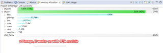

I added and used OTA module on my custom CC3235S board using SDK 6.10.0.5
My cusotm board use 32Mb sFlash.
I was able to upload the tar file to my github and download it via OTA module.
Below is the device state before OTA.
and it's binary memory (it called v1)

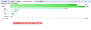

Below is the binary memory used to create the tar file. (it called v2)
I tried the OTA, and it was able to find the download link.
But OtaArchive_process is return -20109. It is ARCHIVE_STATUS_ERROR_BUNDLE_CMD_MAX_OBJECT.
I can't figure out what causes this error to occur.
I reduced the heap capacity in v2 and moved the .data area from SRAM to SRAM0 due to lack of memory. Could this be the cause?
Please give me some advice.
