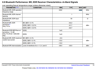

I am using BT RF testing document (Dated 1/15/2021) WL18xx Bluetopia PM Bluetooth RF Testing. In this document in page 2, possible values for frequency are mentioned as f=2402 ~ 2479. However, I would like to set frequency as 2480. Does it mean, this value won't be possible? Please clarify. As part of restricted band-edge test I will have to set frequency to 2480 and hence the question.

    As seen in our datasheet (https://www.ti.com/lit/SWRS152) it is definitely possible to reach frequency 2480Mhz.
