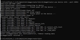

I would like to flash or debug our custom board. When I try to debug with code composer studio I get the following error message.
When I try to query the MAC address, I get a timeout:
The custom board ran without errors, then a measurement was taken with the oscilloscope. After that, the device no longer worked. I can't explain exactly what the reason could be, maybe you have an idea.
When trying to debug or flash the device, the above error messages appear.

    According errors above it looks that your CC3235SF chip is damaged or you have issue with power source or other components at your board. At first step check power source and visually inspect your board. If all  will be OK, than exchange CC3235SF QFN chip.
    Jan
  • Hi Vignesh,
    Based on the description where everything was working until some physical probing, my expectation is physical damage as well. Potentially ESD, but I would guess potential shorting from the scope probe. This has been my experience on occasion when trying to connect the alligator GND clip on a dense board.
    What exactly were you probing?
