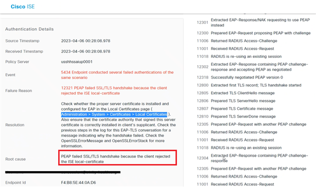

We are using CC3200 for the IOT devices, and we bypass the certificate for WIFI PEAP MSCHAP authentication.
It had been working for an year. Once our customer has installed the PEAP certificate on the ICE server, all the devices are disconnected from the network.
We checked the ICE server, and it says the below error message. It seems like after bypassing the certificate, the device tries to validate the certificate.
Do you have any suggestions for fixing this issue?
