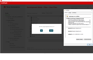

  • Hi Kobi,
    I downloaded the certificate from Uniflash, but the content is right as I can see it. Please see below:
  • Did you rebuild the ota library following the otauser.h update?
    Make sure to build the library and that verify that the newly created lib file is linked with the application.
  • I switched to the new SDK and got it to work. For me it seems that the issue was that it needed support for two certificates which is introduced in the new SDK. BTW I think TI should check if documents should be updated when releasing new SDK. I.e. the OTA document for CC3220SF does not reflect the instructions in Simplelink Academy. And in the Simplelink Academy the latest SDK is 6.10 while the latest SDK released is 7.10.
  • It is not that 2 certificates are needed for the connection, but the new SDK allows (Actually from 6.10) you to set 2 root CAs so the OTA_IF module can try both (try to connect with the first and if it fails it will retry with the 2nd). It was made specifically for supporting a transition period when the server may switch to a new certificate (so temporarily you need both the old and new root CA).
    We know that the SL Academy was not updated with the recent SDK. I currently can't commit to a date in which it will be updated.
    For now (until the SL Academy is updated) the Readme of the MQTTClient example is the best resource of information.
