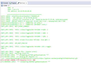

I'm using MQTT client Example code  to test OTA feature. After pressing SW2 switch on the Launchpad, got an error saying "[OTA-GITHUB::ERROR] HTTP Response Error: 400".
Attached image is for Reference.
Please check and let me know what is the issue.
Manjunath
    The 400 error means a bad HTTP request.
    It means that it does not like something on the HTTP URI.
    Can you double check?

    Manjunath
    As you can see under the uri: printout, the URL looks strange (with https: in the middle).
    You need to supply with the right URL to where the tar file resides.
    GITHUB_USER_NAME and GITHUB_USER_REPO looks OK but GITHUB_USER_PATH is not.
    The URI in the code comes from:
    #define REQUEST_URI         "/repos/" GITHUB_USER_NAME "/" GITHUB_USER_REPO "/contents/" GITHUB_USER_PATH
    And you need to make sure that the final URL is exactly where your tar file is.

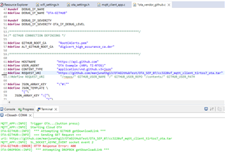

    I updated the path and still getting same error.
    Please check attached screenshot for reference.
    Manjunath
    You can see that REQUEST_URI does not correlate to where the tar file really is and this is why it fails.
    Can you manually modify it just for the test? i.e. change "#define REQUEST_URI         "/repos/" GITHUB_USER_NAME "/" GITHUB_USER_REPO "/contents/" GITHUB_USER_PATH" to the right location (i.e. like the one in the last picture you sent). I believe the URL also includes the actual filename cc3220sf_mqtt_client_tirtos7_ota.tar in your case).
    Shlomi
  • can you please attach your ota_vendor_github.c file?
    I want to see the HOSTNAME.
    Basically, if you type in a browser the following, you should get a json with a list of your files.
    https://api.github.com/repos/manjunathg13/OTAGitHubTest/contents/OTA_SEP_07.
    This is exactly the same syntax as in the code.
    And this is what I get which looks OK:
        "name": "cc3220sf_mqtt_client_tirtos7_ota.tar",
        "path": "OTA_SEP_07/cc3220sf_mqtt_client_tirtos7_ota.tar",
        "sha": "d5479c4d9818ca51d64a98e7d6b12e2372534277",
        "size": 378880,
        "url": "https://api.github.com/repos/manjunathg13/OTAGitHubTest/contents/OTA_SEP_07/cc3220sf_mqtt_client_tirtos7_ota.tar?ref=main",
        "html_url": "https://github.com/manjunathg13/OTAGitHubTest/blob/main/OTA_SEP_07/cc3220sf_mqtt_client_tirtos7_ota.tar",
        "git_url": "https://api.github.com/repos/manjunathg13/OTAGitHubTest/git/blobs/d5479c4d9818ca51d64a98e7d6b12e2372534277",
        "download_url": "https://raw.githubusercontent.com/manjunathg13/OTAGitHubTest/main/OTA_SEP_07/cc3220sf_mqtt_client_tirtos7_ota.tar",
        "type": "file",
        "_links": {
          "self": "https://api.github.com/repos/manjunathg13/OTAGitHubTest/contents/OTA_SEP_07/cc3220sf_mqtt_client_tirtos7_ota.tar?ref=main",
          "git": "https://api.github.com/repos/manjunathg13/OTAGitHubTest/git/blobs/d5479c4d9818ca51d64a98e7d6b12e2372534277",
          "html": "https://github.com/manjunathg13/OTAGitHubTest/blob/main/OTA_SEP_07/cc3220sf_mqtt_client_tirtos7_ota.tar"
    Please try to understand where in the flow it breaks and gives you the 400 error.
  • Please find attached ota_vendor_github.c file

    #define HOSTNAME            "https://api.github.com"
    #define USER_AGENT          "OTA Example (ARM; TI-RTOS)"
    #define CONTENT_TYPE        "application/vnd.github.v3+json"
    #define REQUEST_URI "https://github.com/manjunathg13/OTATest/20230829154147_CC3220SF_cc3220sf_mqtt_client_tirtos7.tar"
    //#define REQUEST_URI         "/repos/" GITHUB_USER_NAME "/" GITHUB_USER_REPO "/contents/" GITHUB_USER_PATH

    If I update the #define REQUEST_URI         "">github.com/.../cc3220sf_mqtt_client_tirtos7_ota.tar"
    Getting"[MQTT_APP::INFO]  SL_SOCKET_ASYNC_EVENT socket event 2" in the UART. Please find attached image for reference.
    OK, at least I can see that the json file is fine.
    Please keep the regular settings where the uri is built automatically.
    Basically, the way it works is that the json file is received and then the download_url is parsed and used.
    To understand more, you need to understand where it fails exactly (getting the json, download_url, other).
    I suggest opening the internal OTA debug by SL_ENABLE_OTA_DEBUG_TRACES in otauser.h.
