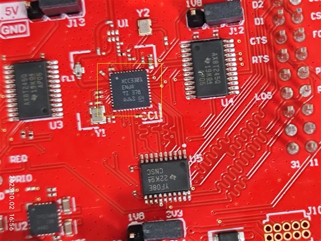

    It is confirmed to be a CC3301 which is a WiFi+BLE chip.
    /ckhsu

      For your information, our latest BP-CC33X1 board in hand for PG2.0 is Rev E3 printed on PCB.

    It seems as though the Device uart is not being picked up by the Beaglebone. I want to make sure the reworks needed in the beaglebone adapter for the CC3301 is correct. The reworks look like the following.
    I have just tested running the scripts on a setup with an OOB distribution and it worked properly.
    Kind Regards,
    Rogelio
  • Hi Rogelio:
      Ok, it seems the BP-CC33-BBB-ADAPT need modification.
      Can you let me know where can I find the detail hardware modification inside the document?
    /ckhsu

    Im glad the chip is working properly and you were able to get the demo up and running. It seems as though your FAE will be reworking the adapter board and sending it your way. All of the UART (RTS,CTS,RX,TX) have to be reworked.
