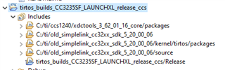

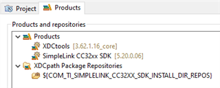

The 'tirtos_builds_CC3225SF_LAUNCHXL_release_ccs' project builds with no errors using SimpleLink CC32xx SDK [5.20.0.06] :

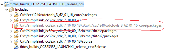

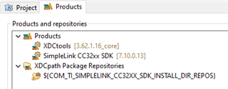

But, changing to SimpleLink CC32xx SDK [7.10.0.13], I get a 'PACKAGE_NOT_FOUND' error:

Is the circled auto-generated include file correct?
How do I fix this?

    It seems that your project is based on TI-RTOS 6 but support for this version was dropped at latest SDK. Latest SDK (7.10.0.13) supports TI-RTOS 7 only. But please wait for confirmation from TI side.
    To add support of latest SDK into your project, you will need to port to TI-RTOS 7. I am not able say how much effort this can take at your case.
