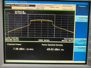

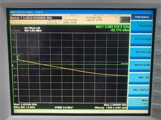

WL1837MOD: Failing spurious emission test at China SRRC tests - Need to know if CH13 of 2.4GHz can be disabled permanently.
Part Number: WL1837MOD
Dear TI Team,
We are performing wireless test on our product for China market. When continuous Tx is enabled in 2.4GHz C13, the side band is above the limit at 2483.5MHz in 802.11g and 802.11n protocols.
It is not possible to suppress the side band. The power of CH13 has been already set to 00 using the .ini file. But this is not helping.
Is it possible to permanently disable CH13?
