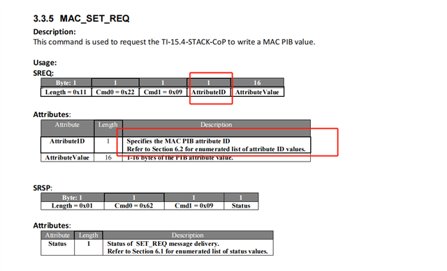

1.
In the website,
https://software-dl.ti.com/lprf/ti15.4stack_linux_x64/2.01.00.10/exports/docs/TI-15.4%20Stack%20CoP%20Interface%20Guide.pdf
I can't find the attribute ID in link of 6.1 or 6.2.
2.

  • Hi Marvin,
    1.Which PDF can I find the attributes id ?

    The attributes ID are located on page 63 in the pdf. It seems that the link is wrong. It should not be 6.2, but 4.2 instead. Will look into the other problem.
