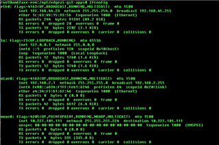

  • Hey Mickael,
    Please use the attached files and following steps in the meantime. I will continue to work on figuring out the 9.1 dts but I think there is a possibility you will get the functionality you need using sdk 9.1 and the old dts, so please test it and let me know once you bring it up.
    1. Flash the microSD card with the prebuilt AM62A WIC image: https://dr-download.ti.com/software-development/software-development-kit-sdk/MD-D37Ls3JjkT/09.01.00.07/tisdk-edgeai-image-am62axx-evm.wic.xz
    2. On a Linux-based host PC, install the AM62 Processor SDK: https://dr-download.ti.com/software-development/software-development-kit-sdk/MD-D37Ls3JjkT/09.01.00.07/ti-processor-sdk-linux-edgeai-am62axx-evm-09_01_00_07-Linux-x86-Install.bin
    3. Download the CC33xx SDK: https://dr-download.ti.com/software-development/driver-or-library/MD-ROCBq4vAGl/1.0.0.1/am62x-cc33xx-linux-package-1.0.0.1-linux-x64-installer.run
    4. Navigate to the ti linux kernel source directory:
      cd ~/ti-processor-sdk-linux-edgeai-am62axx-evm-09_01_00_07/board-support/ti-linux-kernel-6.1.46+gitAUTOINC+247b2535b2-g247b2535b2
    5. Patch the TI linux kernel with the CC33XX kernel patches and config patches from the CC33xx sdk (I included an already compiled dtb so you don't have to patch the dts)
      patch -p0 < ~/cc33xx/patches/cc33xx_kernel.patch
      patch -p0 < ~/cc33xx/patches/cc33xx_ti_config.patch
    6. Set the path and make sure the kernel is clean
      export PATH=~/ti-processor-sdk-linux-am62xx-evm-09.01.00.08/linux-devkit/sysroots/x86_64-arago-linux/usr/bin/aarch64-oe-linux:$PATH
      make ARCH=arm64 CROSS_COMPILE=aarch64-oe-linux- distclean
    7. Set the configuration and build the kernel, modules, and devicetree
      make ARCH=arm64 CROSS_COMPILE=aarch64-oe-linux- defconfig ti_arm64_prune.config
      make ARCH=arm64 CROSS_COMPILE=aarch64-oe-linux- Image modules -j8
    8. Install the kernel, modules, and DTBs
      sudo cp arch/arm64/boot/Image /media/<user>/rootfs/boot/
      sudo make ARCH=arm64 modules_install INSTALL_MOD_PATH=/media/<user>/rootfs/
      sudo cp <directory for dtb I included below> /media/user/rootfs/boot/dtb/ti/
    9. Fix the format of the CC33xx scripts by navigating to the correct directory and running the formatting command belowcd ~/cc33xx/cc33xx_rootfs/usr/share/cc33xx
      dos2unix *
    10. Install the CC33XX firmware and example scripts by copying the contents under "ccc33xx_rootfs" (included in the CC33xx_AM62A_Bringup folder below) into the SD card's root directory
      cd <path_to_cc33xx_folder>/cc33xx_rootfs
      sudo cp -r * /media/<user>/rootfs/
      sync

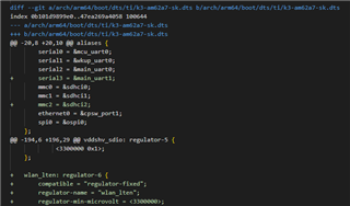

  • Hi Corinne,
    First i test your wic image provided at point 1. The image works like my yocto build (with mosquitto, modemManager ...)
    Then i installed the 9.1.00.07 sdk
    Patch the kernels, dts files ... I needed to add my patch compare to your process to modify k3-am62a7-sk.dtb ...
    But don't work for me. See the boot log below

  • Hi Corinne, under the result of the commande
    root@am62axx-evm:/opt/edgeai-gst-apps# ls /sys/firmware/devicetree/base/
    '#address-cells'   aliases     clk-0        cpus           interrupt-parent   memory@80000000   opp-table     regulator-1   regulator-4   regulator-7       sound
    '#size-cells'      bus@f0000   compatible   dma_buf_phys   l2-cache0          model             pmu           regulator-2   regulator-5   regulator-8       thermal-zones
     __symbols__       chosen      connector    firmware       leds               name              regulator-0   regulator-3   regulator-6   reserved-memory   timer-cl0-cpu0
  • Retry your procedure above.

  • Hi Mickael,
    Could you please try applying the attached additional patches?  This should add the necessary cc33xx wlan support to your AM62A dts in sdk 9.1 kernel.
    I tested this along with Corinne's instructions and was able to get this to work on the SK-AM62A-LP (E3 revision) together with an M.2 CC3301 (E2 revision).
    Hopefully we can get this working for you before the end of the week.
    ~roger
    https://e2e.ti.com/cfs-file/__key/communityserver-discussions-components-files/968/k3_2D00_am62a7_2D00_sk.dts.cc33.patch
    https://e2e.ti.com/cfs-file/__key/communityserver-discussions-components-files/968/k3_2D00_am62a_2D00_main.dtsi.cc33.patch
    I applied your patch to my yocto image.
    It works partialy, now it seems that the module is detected (sdio) but there is an error when loading the firmware.

    root@am62axx-evm:/opt/edgeai-gst-apps# ip a
    1: lo: <LOOPBACK,UP,LOWER_UP> mtu 65536 qdisc noqueue state UNKNOWN group default qlen 1000
        link/loopback 00:00:00:00:00:00 brd 00:00:00:00:00:00
        inet 127.0.0.1/8 scope host lo
           valid_lft forever preferred_lft forever
        inet6 ::1/128 scope host
    2: eth0: <NO-CARRIER,BROADCAST,MULTICAST,UP> mtu 1500 qdisc mq state DOWN group default qlen 1000
        link/ether 1c:63:49:15:93:5b brd ff:ff:ff:ff:ff:ff

    the difference that i have with your patch is here with aliases. I will try to remove it

    received the M2 wifi board rev2 this morning !
    Now it works at first boot, super !!!
    Thank you for your help.
