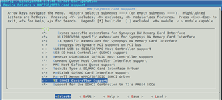

    Before the build, i also need to disable certificate with this command
    scripts/config --disable SYSTEM_TRUSTED_KEYS
    scripts/config --disable SYSTEM_REVOCATION_KEYS
    And enable "Ti K3" in config and "TI SDHCI Controller Support"

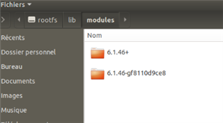

    After copy and install module and cc33xx driver in rootfs, boot the board with the new kernel.
    The boot process stuck at this lines
    [ 1.176282] Waiting for root device PARTUUID=b3ea3bda-02...
    [ 11.180697] ti-sci-inta 4e0a0000.interrupt-controller: deferred probe timeout, ignoring dependency
    [ 11.189881] ti-sci-inta: probe of 4e0a0000.interrupt-controller failed with error -110
    [ 11.199130] platform 1082e0.clock: deferred probe pending
    Start of boot :
    Starting kernel ...
    [    0.000000] Booting Linux on physical CPU 0x0000000000 [0x410fd034]
    [    0.000000] Linux version 6.1.46+ (mlestephan@ubuntu) (aarch64-oe-linux-gcc (GCC) 11.3.0, GNU ld (GNU Binutils) 2.38.20220708) #2 SMP PREEMPT_DYNAMIC Wed Dec  6 22:21:13 CET 2023
    [    0.000000] Machine model: Texas Instruments AM62A7 SK
    [    0.000000] earlycon: ns16550a0 at MMIO32 0x0000000002800000 (options '')
    [    0.000000] printk: bootconsole [
    Perhaps there is an issue with the kernel version generated. When i copy module to the target i have this 2 folders
    The new kernel is 6.1.46+ and the original is 6.1.46-gf8110d9ce8
    An idea please ?
