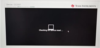

We designed the CC3301 module by ourselves, but our module has been unable to be detected when using simplelink_wifi_toolbox_2.0.8.fcs.
We connected SCLK, SWDIO, RST pull 3V3, VCC, GND, but it keeps showing checking for reset.
We measured RST and connected it to a high potential, but it still pulled it to a low level.

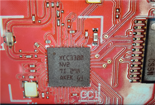

Our chip model is the NV1 version, but TI's development board is the NV2 version. Will there be any impact?

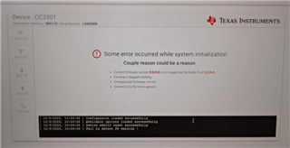

In addition, we also tried using version simplelink_wifi_toolbox_2.0.11, but the following message was displayed.
Regarding this issue, TI experts, do you have any suggestions to provide us?
