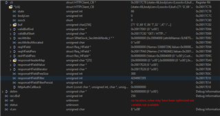

  • Hey Jan,
    We have been using the JTAG to debug during this whole process. This is what we see going on in the example:
    - The code calls HTTPClient_sendRequest() in line 92 of the httpget.c file in the example.
    - This function then calls sendRequest() inside of it.
    - Inside of sendRequest() in the httpclient.c source file, the function getStatus() is called, where the -3003 error comes from.
    The only thing that could be returning -3003 inside the getStatus() function is the code that we attached above. I am confused, is this point in the code still evaluating the request before even sending it? I've attached an image below of what the client struct looks like when I am inside of getStatus() before it returns with -3003.
    How are set pointers validBufStart and validBufEnd at return HTTPClient_ERESPONSEINVALID?
    Jan
  • Hey,
    I stopped the debug process at this breakpoint right here.
    And here is what the client struct looks like.
    I believe this should mean the string comparison would always fail since GET would be compared with the HTTP version.
    Greg
