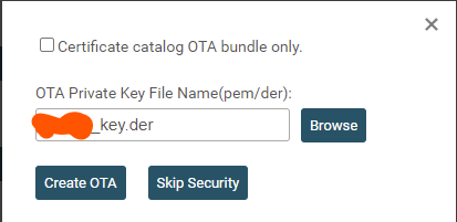

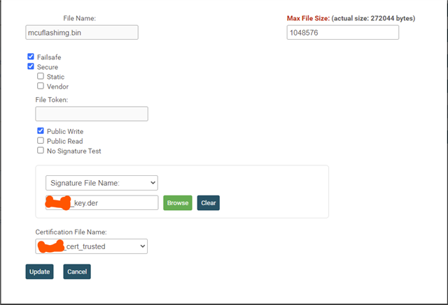

I try to implement an OTA update. mcuflashimg.bin is signed and flashed with OTP and vendor catalog over UART successfully. That works well without any security/certificate problems.

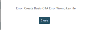

When I'm trying to flash via OTA the procedure fails with OtaArchive status=-20199. I think it is because the OTA is created without security/private key. When I try to create the OTA with the vendor private key, it fails with "Error: Create Basic OTA Error: Wrong key file".

Creating the OTA
Which key should I use?

  • Please read the OTA documentation (specifically see chapter 3.2 in <SDK_ROOT_FOLDER>/docs/simplelink_mcu_sdk/Over_The_Air_Update_Guide.html).
    The secure image certificate can only use ECC key (secp256r1 elliptic curve private key) as the full image authenticity is being verified using the CC32xx Crypto Utils  where RSA is not supported - see more details in chapter 17 of "the programmer's guide" (code can be found in <SDK>/source/ti/net/ota/source/ota_archive.c).
    To enable this you will also need to program the certificate to the CC32xx file system (name it "dummy_ota_vendor_cert.der" or change the definition "ota_archive,c") before you are trying to load the image.
    For development you can use the example key-pair in the "<SDK>/tools/cc32xx_tools/ota-example-cert/". For production, you will need to create your key-pair based on the support elliptic curve.

  • Hi Kobi for testing purposes I used the dummy ota key and cert, added the cert to the vendor cert catalog. The dummy ota cert is included in the Userfiles and otaArchive.c OTA_CERTIFICATE_NAME is adapted to the ota cert. The device is flashed via Uniflash to update the cert catalog.
    The ota image is created successfully. The ota update itself still fails with -20199.
    Is it necessary to sign the ota certificate by the vendor key?
  • No. the OTA cetificate must be self-signed (root).
