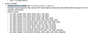

  • It also says here that it supports TLS networks other than TLS 1.0.
    No. This is for sockets not for EAP. For EAP is supported TLS 1.0 only as I said.
    Jan
  • the network I want to use uses PEAP. does this r-case also have the problem
    Limitation for TLS 1.0 to EAP security is for all EAP methods. What I am not sure about CISCO FAST_* methods, but these are used rarely.
    If network use PEAP EAP method, but TLS 1.0 is not allowed, there is no way how to connect CC3235 into these network using EAP security and you can't do anything about this.
