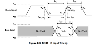

In the process of design validation customer is inspecting the interface signals. One concern pertains to the setup timing for the input data signal before the rising edge of the CLK. The image below shows the CLK (Yellow) and D3 Data signal on the WIFI (Blue):
The table below is the other data signals compared to the expected measurements from the datasheet:

From the capture it seems to be hard to achieve the >6ns setup time spec, is there any screen captures or testing data that customer can use for reference?
The data signal also shows some asymmetry, is that also expected ? If this looks off to you as well we would appreciate your comments as to what could cause this and how this can be improved

    The only measurement that looks strange here is the Setup time, which as you said is not greater than 6 ns. How did you measure this? Be sure to measure as shown in the timing diagram shown in the datasheet, parameter t_ISU:
    This is the time that the data line should be stable (greater than VIH if logic high or less than VIL if logic low) before the CLK line goes high (goes beyond 50% VDD).
    From what I see the scope capture looks good to me. The real test is if the CC3301 is able to successfully interface with the host. Are you seeing any issues with SW or with the host driver?

    I looked again at the scope capture you sent, I see that your measurement was valid.
    Can you share what is on the SDIO lines in your schematic? What host are you using and what components are in-between the host and the CC3301? Level shifters? passives of any kind?
    Jonathan
