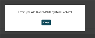

  • Hi
    Thank you for your response. the document is helpful. I was able to read the user files using the "Online User Files" option on a healthy device. But, On the problem device, when try reading "Online User Files" it gives me the following error -
    What does this error mean? I can confirm the device is in Development Mode.
    It seems that file is damaged, likely not properly closed during write. What flags do you have set for this file?
    Jan
  • When i flash the application binary using Uniflash - these are the flags that are set.
    I think with such flags you should not be allowed read file. Use public read or vendor token during file creation.
