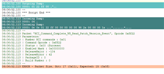

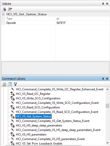

    I didn't found the command 0xFE1F in HCI tester  Commands List , how can I write a custom command ?
    and I found the command  HCI_VS_Read_Patch_Version (0xFF22) will always said the reply error in package size. there is a log file.
    In fact, the module was reply mcu around 36 bytes data.
    <HTML>
    <HEAD>
    <TITLE>HCITester Log</TITLE>
    </HEAD>
    <BODY>
    <FONT face="Courier New">
    <TABLE ALIGN=LEFT CELLSPACING=0 width=3500 CELLPADDING=0>
    <tr bgcolor="ffffff"><td><font color="000000">06:06:24.898 *** Script Started: ***</font></td></tr>
    <tr bgcolor="ffffe6"><td><font color="0000c0">06:06:24.899 --</font></td></tr>
    <tr bgcolor="ffffe6"><td><font color="0000c0">06:06:24.899 Packet "HCI_VS_Read_Patch_Version", Opcode 0xff22</font></td></tr>
    <tr bgcolor="60c0c0"><td><font color="ffffff">06:06:24.899 Outgoing Dump:</font></td></tr>
    <tr bgcolor="60c0c0"><td><font color="ffffff">06:06:24.899     0000: 01 22 ff 00                                     ."..</font></td></tr>
    <tr bgcolor="ffffff"><td><font color="000000">06:06:24.899 --</font></td></tr>
    <tr bgcolor="ffffff"><td><font color="000000">06:06:24.899 *** Script End ***</font></td></tr>
    <tr bgcolor="ffffff"><td><font color="000000">06:06:52.100 *** Script Started: ***</font></td></tr>
    <tr bgcolor="ffffe6"><td><font color="0000c0">06:06:52.100 --</font></td></tr>
    <tr bgcolor="ffffe6"><td><font color="0000c0">06:06:52.100 Packet "HCI_VS_Read_Patch_Version", Opcode 0xff22</font></td></tr>
    <tr bgcolor="60c0c0"><td><font color="ffffff">06:06:52.100 Outgoing Dump:</font></td></tr>
    <tr bgcolor="60c0c0"><td><font color="ffffff">06:06:52.100     0000: 01 22 ff 00                                     ."..</font></td></tr>
    <tr bgcolor="ffffff"><td><font color="000000">06:06:52.100 --</font></td></tr>
    <tr bgcolor="ffffff"><td><font color="000000">06:06:52.100 *** Script End ***</font></td></tr>
    <tr bgcolor="408080"><td><font color="ffffff">06:06:52.113 Incoming Dump:</font></td></tr>
    <tr bgcolor="408080"><td><font color="ffffff">06:06:52.113     0000: 04                                              .</font></td></tr>
    <tr bgcolor="408080"><td><font color="ffffff">06:06:52.113     0000: 0e 0e 01 22 ff 00 00 00 00 00 98 2a 00 00 00 1a ...".......*....</font></td></tr>
    <tr bgcolor="fff7fa"><td><font color="006400">06:06:52.113 --</font></td></tr>
    <tr bgcolor="fff7fa"><td><font color="006400">06:06:52.113 Packet "HCI_Command_Complete_VS_Read_Patch_Version_Event", Opcode 0xff22</font></td></tr>
    <tr bgcolor="fff7fa"><td><font color="006400">06:06:52.113 Parameters:</font></td></tr>
    <tr bgcolor="fff7fa"><td><font color="006400">06:06:52.113 | Number HCI commands : 0x01</font></td></tr>
    <tr bgcolor="fff7fa"><td><font color="006400">06:06:52.113 | Command Opcode      : 0xff22</font></td></tr>
    <tr bgcolor="fff7fa"><td><font color="006400">06:06:52.113 | Status              : 0x00 (Success)</font></td></tr>
    <tr bgcolor="fff7fa"><td><font color="006400">06:06:52.113 | Enabled Mask        : 0x00000000</font></td></tr>
    <tr bgcolor="fff7fa"><td><font color="006400">06:06:52.113 | ReleaseMajor        : -104</font></td></tr>
    <tr bgcolor="fff7fa"><td><font color="006400">06:06:52.113 | ReleaseMinor        : 42</font></td></tr>
    <tr bgcolor="fff7fa"><td><font color="006400">06:06:52.113 | PackageID           : 0</font></td></tr>
    <tr bgcolor="fff7fa"><td><font color="006400">06:06:52.113 | Build Number        : 0</font></td></tr>
    <tr bgcolor="ffc0a0"><td><font color="000000">06:06:52.113 ERROR - Packet Size. Got: 17 (0x11), Expected: 15 (0x0f)</font></td></tr>
    </TABLE>
    </FONT>
    </BODY>
    </HTML>

    I was able to find the FE1F on HCITester
    Are you using the correct xml file for hci tester. It can be found in the following package
    https://www.ti.com/tool/CC256XC-BT-SP
