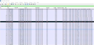

We have seen wifi transfer suddenly stop during bigger downloads (FOTA). A simpler testcase is running iperf, and the test often stops before the 10 seconds finishing. The testcase here is simply enabling iperf3 in the firmware, connecting to wifi and running iperf over the wifi link.  Our analysis suggests that the WiFi firmware loses received packets over a period of time, leading to TCP transmission interruptions, but this situation can be recovered.  The question is how to prevent this situation from happening?
[08:30:36.213] # iperf3 -s
[08:31:49.391] Server [192.168.5.94] listening on [5201]
[08:31:49.391] -----------------------------------------------------------
[08:31:55.115] Accepted connection from 192.168.5.1, port 46328
[08:31:55.539] [  5] local 192.168.5.94 port 5201 connected to 192.168.5.1 port 46330
[08:31:56.553] [ ID] Interval           Transfer     Bandwidth
[08:31:56.553] [  5]   0.00-1.00   sec  1.01 MBytes  8.44 Mbits/sec
[08:31:57.905] [  5]   1.00-2.36   sec  761 KBytes  4.60 Mbits/sec
[08:31:58.549] [  5]   2.36-3.00   sec  1.56 MBytes  20.3 Mbits/sec
[08:31:59.549] [  5]   3.00-4.00   sec  2.58 MBytes  21.7 Mbits/sec
[08:32:00.549] [  5]   4.00-5.00   sec  2.50 MBytes  21.0 Mbits/sec
[08:32:01.549] [  5]   5.00-6.00   sec  2.08 MBytes  17.5 Mbits/sec
[08:32:02.550] [  5]   6.00-7.00   sec  1.85 MBytes  15.6 Mbits/sec
[08:32:03.545] [  5]   7.00-8.00   sec  1.60 MBytes  13.4 Mbits/sec
[08:32:04.925] [  5]   8.00-9.38   sec  686 KBytes  4.08 Mbits/sec
[08:32:05.550] [  5]   9.38-10.00  sec  115 KBytes  1.51 Mbits/sec
[08:32:06.555] [  5]  10.00-11.01  sec  0.00 Bytes  0.00 bits/sec                  <<<<
[08:32:07.555] [  5]  11.01-12.01  sec  0.00 Bytes  0.00 bits/sec
[08:32:08.555] [  5]  12.01-13.01  sec  0.00 Bytes  0.00 bits/sec
[08:32:09.555] [  5]  13.01-14.01  sec  0.00 Bytes  0.00 bits/sec

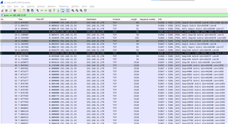

  • Hi Sabeeh
    We have discovered a method that seems can fix this issue. The method is changing power-saving mode of the WiFi chip. Originally set to 'auto', changing it to 'active' appears to make the problem disappear. Therefore, is the power-saving mode the root cause of this issue? Could the 'auto' mode have such a significant impact on TCP traffic? What potential issues might arise from switching to 'active' mode?
  • Hi Yuan,
    We don't have a iperf3 implemented on R6 SDK, so I'm unable to replicate this issue. Would you be willing to provide your implementation of iperf3 so that I can run in on my hardware? I can then better reproduce the issue.
    There is no issue with using active power mode, the device will instead may have a higher power consumption. The issue could be related to using power save mode, but we will need to investigate this further to confirm.
  • Hi Sabeeh

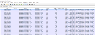

    iperf3 is not necessary, iperf also can do this test.
     In our further testing, setting the power save mode to active can only mitigate this issue. If the device maintains the connection and there is no data transmission for a while, the next time data transmission starts, the rate will still drop to 0. Another problem is that both WLAN_SET_POWER_SAVE and WLAN_SET_POWER_MANAGEMENT are used to configure power save mode. What is the difference between these two parameters, and how should they be set to ensure that the Wi-Fi remains in active mode continuously?

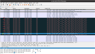

  • When WLAN_SET_POWER_SAVE is set to auto, this issue occurs. Does this indicate that the auto mode has a bug? Does the FW need to fix this issue?
  • Hi Yuan,
    Yes it does sound like a bug, but we have addressed many issues in the firmware, we would need the firmware to be updated in the SDK release and then test again.
    However, we can try to understand the bug as it is. Would you be able to collect FW logs from the LOGGER pin? I can then review with the team and see if this issue has already been addressed internally.

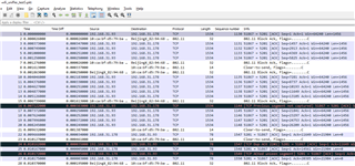

    In addition I have sent youand your team an engineering FW that should improve or fix the behavior.
    It is critical to get logs if we want to understand the issue and fix it.
    This Fw log file, pletcp_throughput.pcapng.txtase check it.

    I saw one frame in the sniffer capture here where the CC33xx says it's going to sleep. Can you please confirm if this test was conducted with WLAN_STATION_ACTIVE_MODE or AUTO?
  • Hi Yuan,
    This sniffer is much more readable, so thank you for that. However, we are trying to chase the issue where the throughput drops to 0 for multiple seconds. In the iperf log, I see that the throughput momentarily drops to 0. Are you able to collect a sniffer capture where the throughput drops for a long time as reported before?
  • One additional question, it seems that both sniffer captures (wifi_sniffer_test5.pkt and pc_tcp_iperf3_test5.pcapng) dont line up. Meaning, we don't see the same TCP packets that are in both logs because the TCP sequence numbers do not contain the same values. Were these two captures taken at the same time?
  • Hi Sabeeh
    the cmd "get_ps" shows it is active mode.
    The packet captures were indeed taken simultaneously, and the port numbers match. The sequence numbers from the device side can be correlated.

    Could you please suggest how to correlate the logs? Because we see from the TCP sequence numbers that they do not match.
    For example, see the following two images from both captures. The Sequence value from within each TCP packet do not align to each other.
  • Indeed, the sequence numbers of the TCP packets sent by the PC in the two files do not match—possibly due to router tampering. However, to identify the same TCP packets across both files, we can still match them based on the TCP payload.
    Now, we’ve found that the 244th packet in the **pc_tcp_payload_test5** file corresponds to the 1st packet in the **wifi_sniffer_test5** file. With this alignment, we can use these two packets as references to correlate all subsequent TCP packets.
  • I'm not sure what you mean, could you please provide a screenshot? Here is what I see and they don't match up. The TCP packets don't align either.
