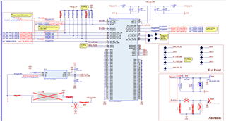

We couldn't bring up WL1835MOD chip on our board based AM67A.
I compare our board and BeagleBone Black(TI AM335x) board that use WL1835MOD chip.

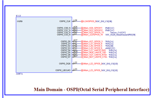

Our device tree and schematic of OSPI interface :

	wifi_pins_default: wifi-default-pins {
		pinctrl-single,pins = <
			J722S_IOPAD(0x0120, PIN_INPUT_PULLUP, 0) /* (F27) MMC2_CMD */
			J722S_IOPAD(0x0118, PIN_OUTPUT, 0) /* (H26) MMC2_CLK */
			//J722S_IOPAD(0x011C, PIN_INPUT_PULLUP, 0) /* () MMC2_CLKLB */
			J722S_IOPAD(0x0114, PIN_INPUT_PULLUP, 0) /* (G26) MMC2_DAT0 */
			J722S_IOPAD(0x0110, PIN_INPUT_PULLUP, 0) /* (G27) MMC2_DAT1 */
			J722S_IOPAD(0x010c, PIN_INPUT_PULLUP, 0) /* (H27) MMC2_DAT2 */
			J722S_IOPAD(0x0108, PIN_INPUT_PULLUP, 0) /* (J27) MMC2_DAT3 */
	wifi_pins_default_sleep: wifi-default-pins_sleep {
			J722S_IOPAD(0x0120, PIN_INPUT_PULLDOWN, 0) /* (F27) MMC2_CMD */
			//J722S_IOPAD(0x011C, PIN_INPUT_PULLDOWN, 0) /* () MMC2_CLKLB */
			J722S_IOPAD(0x0114, PIN_INPUT_PULLDOWN, 0) /* (G26) MMC2_DAT0 */
			J722S_IOPAD(0x0110, PIN_INPUT_PULLDOWN, 0) /* (G27) MMC2_DAT1 */
			J722S_IOPAD(0x010c, PIN_INPUT_PULLDOWN, 0) /* (H27) MMC2_DAT2 */
			J722S_IOPAD(0x0108, PIN_INPUT_PULLDOWN, 0) /* (J27) MMC2_DAT3 */
	wifi_en_pins_default: wifi-en-default-pins {
			J722S_IOPAD(0x0010, PIN_OUTPUT, 7) /* (L27) OSPI0_D1.GPIO0_4 */
	wifi_wlirq_pins_default: wifi-wlirq-default-pins {
			J722S_IOPAD(0x0014, PIN_INPUT, 7) /* (L26) OSPI0_D2.GPIO0_5 */
	wifi_32k_clk: mcu-clk-out-default-pins {
			J722S_MCU_IOPAD(0x0084, PIN_OUTPUT, 0) /* (F12) WKUP_CLKOUT0 */

Are the MII_TXCLK and MII_REFCLK pins special purpose pins for Wi-Fi?
WL1835 can't receive any clock signal, why?

    Schematic snippets:

  • We tried these device-tree configuration. Nothing changed. We listened to the SDIO line on board with the logic analyzer. We cannot get a response from the WL1835MOD.
  • Hi Alp,
    In that case, can you please check that the power rails are good and that you see the "EXT_32K" is the correct frequency? It seems that the WL18x is not able to boot correctly due to either power or 32KHz CLK issues.
  • Hi Sabeeh,
    Powers are OK.
    We can't get any EXT_32K signal at all. The pins of EXT_32K on the WL1835MOD-node are for the correct.
    Does the SOC generate this clock signal directly after waking up or does it need to be specified with another node in the kernel or u-boot device-tree?
  • We can't get any EXT_32K signal at all.
    This is likely the issue then.
    I'm not exactly sure as this is specific to the AM67A. Let me forward this query to that team.
    I will discuss this internally and get back. The current question is on 32k clock availability on AM67A. I will get back on that in a day or two.
    Keerthy
  • Hi ,
    I saw from BeagleY-AI board that they might use 32kHz CLK from AM67A. Is this the correct DTS configuration for the same?
    https://github.com/beagleboard/linux/blob/v6.1.80-ti-rt-arm64-r58/arch/arm64/boot/dts/ti/k3-am67a-beagley-ai.dts#L763C2-L767C4
    Hi
    Do you have 32Khz CLK routed to the WL18xxMOD? I don't see where this signal is coming from on your board.
