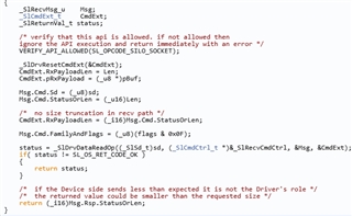

    We are using the definition for the _i16 sl_Recv function from the provided link.SimpleLink CC3120/CC3220 Host Driver: Socket
    Whenever we receive a zero from this function, we encounter a disconnection issue. Could you please help us understand the possible reasons behind this?

  • and just to complete, getting 0 on sl_Recv() means the other side closed the connection (so on a sniffer you would see a TCP FIN from the server to the client).
