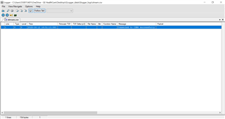

  • Hi Sabeeh,
    I would like to inform you that a call was held with Luke from your organization regarding the WL1835 driver integration, along with another discussion related to a different Wi-Fi driver. Additionally, Luke requested us to share some logs using the gLogger tool from a Windows PC.
    Could you please let me know how to install the gLogger tool on Windows 11, and also what commands or details are required to collect the necessary logs? This will help us provide the appropriate information for better debugging.
    Satya.
  • Hi Sabeeh,
    I could install the gLogger tool succesfully and also connected with the UART settings and could see connection information as shown in the snapshot attached.
    But, the main issue is that we could not take the Debug pin (WL_UART_DBG) out from the existing Board. So looks like the exercise cannot me pulled any more than this.
    Could you please suggest any other way to ge the necessary logs.
  • Hi Team,
    I apologize for the subject of this ticket, but the ticket is raised for the WL1837MOD on imx95 with Linux Kernel 6.6.
    Satya.
  • Hi Satya,
    Just to be clear, you are saying that you do not have access to this DBG pin?

    We could tapout the WL_UART_DBG pin from the WL1837 module and could get some logs when we tried to execute the scan command: "sudo iw dev wlan0 scan | grep SSID". Please find the screen shot and also the same xl sheet attached below.
  • also adding the dmesg command response wlcore in a log below:

  • Hello Satya,
    Good to hear you're able to access the logger pin now. However it seems like there was an issue while taking the logs. Are you using the same firmware (8.9.1.0.2) loaded into the glogger in the parser? Is the baudrate set correctly (3M)?
  • Hi Sabeeh,
    I have used - firmware 8.2.0.0.246 both in the device and also in the gLogger tool. Baud rate used is 152000. I will downgrade the firmware to 8.9.1.0.2 and regenerate the logs and share it with you.
    Please let me know if any more corrections to be done.

  • Hi Sabeeh,
    Thanks for the response with the needed Firmware link.
    I have now loaded the firmware (8.9.1.0.2) into gLogger parser and executed the same scan command - "sudo iw dev wlan0 scan | grep SSID" on the terminal and collected the logs from the gLogger tool respectively.
    Please find the attachment.
    Satya.
    glog_2025_08_07_145148.csv
  • Hello Satya,
    Thank you for providing this, I can see the logs clearly now.
    I don't see any strange behavior here. At the top of the log the scan is received, executed, and results are returned to the host. But for some reason the host doesn't detect
