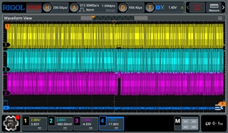

  • Hi AB,
    Thank you for your reply.
    To check the data output of the device,
    I measured the waveform of the SPI communication with an oscilloscope.
    From the waveform I checked, it looked like 2048 bytes of data were being output from the master,
    but the callback function was not being called.
    After that, I paid attention to the 1024 byte limit you mentioned in your reply,
    and added a wait of about 50 usec every 1024 bytes in the SPI communication,
    and the callback function began to be called.
    I would like to avoid adding a wait if possible,
    but is this wait a necessary process?
    I have attached an image of the oscilloscope waveform for reference.
    The signals are 1: MOSI, 2: CLK, 3: MISO, 4: CS.
    Egawa

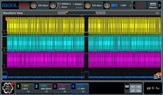

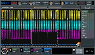

  • Hi AB,
    The wait every 1024 bytes is implemented in the SPI master program.
    A process has been added to wait for a fixed period of time using a timer after sending 1024 bytes of SPI communication.
    In my test environment, when 2048 bytes of SPI communication are performed without waiting,
    the data prepared by the slave (CC3235) is not output from MISO,
    and there is a short period of time when the data input from MOSI cannot be obtained.
    I have attached an image of the waveform measured around 1024 bytes in the above communication.
    Overall waveform
    Enlarged waveform
