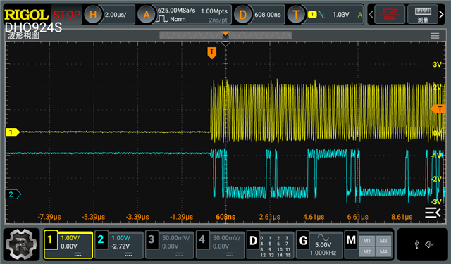

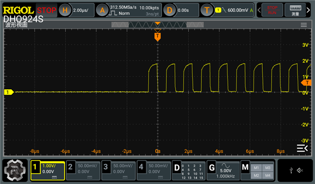

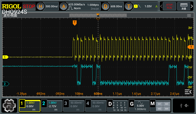

Dear TI Support,
We are currently working to integrate the CC33xx SDIO Wi-Fi module running Linux kernel v6.1.102. The driver was successfully compiled and loaded, but the Wi-Fi module fails to initialize properly.
  1. Hardware was detected via SDIO:
[root@Augentix:/root]# ls -l /sys/bus/mmc/deviceslrwxrwxrwx    1 root     root     0 Jan  1 00:03 mmc1:0001 -> ../../../devices/platform/soc@80000000/818c0000.sdc1_p0/mmc_host/mmc1/mmc1:0001
  1. Both kernel modules were loaded:
[root@Augentix:/root]# lsmod
Module                  Size  Used by    Not tainted
cc33xx_sdio         3889      0
cc33xx                  90836    1
  1. However, during initialization, we encountered the following errors:
mmc1: new SDIO card at address 0001
random: crng init done
overlayfs: upper fs does not support tmpfile.
overlayfs: upper fs does not support RENAME_WHITEOUT.
overlayfs: failed to set xattr on upper
cc33xx_sdio mmc1:0001:2: Using SDIO in-band IRQ
wlcore: cc33xx_probe :: Start
wlcore: Wireless Driver Version 1.7.0.208
wlcore: WLAN CC33xx platform device probe done
wlcore: Chip wakeup
wlcore: Set BLKsize to 128
cc33xx_sdio mmc1:0001:2: sdio read failed (-84)
wlcore: ERROR IO error during core status read
wlcore: ERROR Fatal error during driver init, cannot recover

    We have captured the SDIO waveform (CMD and CLK) using logic analyzer, and confirmed that:
    The I/O voltage level is 1.8V
    Please refer to the attached screenshot from PulseView for reference.
    Given that the waveform appears normal at the hardware level, we’d like to ask:
    Could this sdio read failed (-84) error be more likely related to the SDIO host driver?
    If so, could you kindly advise what aspects we should check on the host side?
    Thanks again for your support!
    WifiInfo_01.zip
  • It could be, hard to say. What is your host processor? Have you tried turning down the SDIO bus speed?
