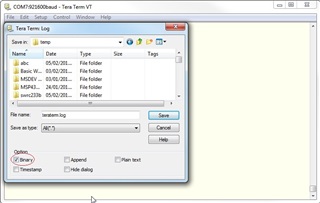

    How often does it happens?
    What kind of traffic are you doing? high throughput?
    Best in these cases is to get a firmware log from the device. there is a dedicated pin for it.

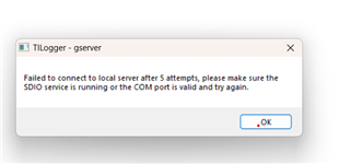

  • Hi Shlomi,
    We are not able to connect getting the below error. When we connect the same com port in mobaxterm we could see some junk data when the wifi driver is up. Please let me know how to resolve this issue?
    when the same come port is connected to the mobaxterm  junk data is continously getting printted.
    Viswa
  • Hi Shlomi,
    Viswa

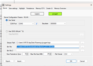

    i changed the baud rate to 115200 , now i ma able to collect the log
    8780.stream.csv
    bin file used in the glogger is same as the bin file used in the target. bin file is taken from the master.
    root@s40-bigbend-v1:/lib/firmware/ti-connectivity# sha256sum wl18xx-fw-4.bin
    3277445a5c14cd467300f1ae214e9484cc5e8e76b73637519d036bf47486f245 wl18xx-fw-4.bin
    root@CHEWA3lMZFtGPe6:/mnt/c/Users/VXR18/Downloads# sha256sum wl18xx-fw-4.bin
    Viswa

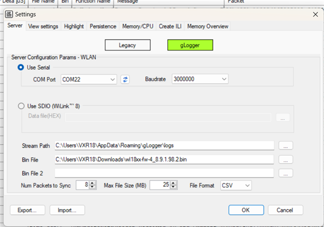

  • Hi Viswa,
    It should be 3M. Other rates would not collect logs properly.
    Are you running in Administrator mode?

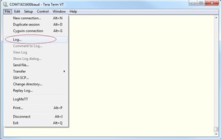

    Just to check that your UART port is OK, can you record the stream of bits coming out from the pin in raw binary mode and share?
    Maybe I will be able to offline see if I can decode it.
    Please note that it must be raw binary.
    I would recommend using TeraTerm since it has binary mode and I know it works on my end.
    Please see some screen captures.
    Shlomi
  • Hi Shlomi,
    Thank you details. Please find the raw binary file.

    Viswa

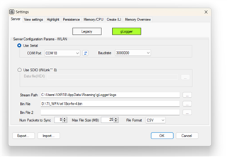

    It must be 3M, not 921600K.
    Shlomi
    When I change the baudrate to 3M , i could notice all the data are comming as FFF
    When budrate is 3000000 all the bin file contents are FF

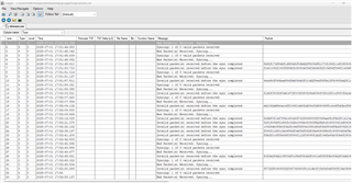

    I could not find the wl12xx_queue_recovery_work() in the csv file.
    8168.stream.csvglog_2025_07_03_171334.csv
    In the below file , we saw the crash 3 times. the crash happened arround 4200, 6700 and 9000 line..
    3681.stream.csvglog_2025_07_03_173127.csv

    Unfortunately the gLogger is corrupted.
    se the .csv file.
    Have you modified the gLogger with the new firmware binary?
    I cannot do much without a gLogger.
    Can you please capture again and make sure the .csv shows good messages?
    Shlomi
    I have copied the given bin file into the /lib/firmware/ticonnectivity and placed another copy in the download folder. Let me know is there any mistake. I have rerun the for the new log.  Please let me know whether this issue is reproducible at your end?

      Please find the attached glogger for the new firmware.
    [ 1110.593001] wlcore: using inverted interrupt logic: 2
    [ 1110.650340] wlcore: PHY firmware version: Rev 8.2.0.0.246
    [ 1111.072461] wlcore: firmware booted (Rev 8.9.1.98.2)
    root@s40-bigbend-v1:/lcc/data/logs/debug# [ 1082.740496] ili9881c-dsi 5a000000.dsi.0: TE pulse count observed is 1198
