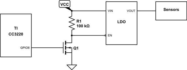

After producing a run of hardware for a new design, we discovered a small oversight in the design we're hoping to fix in firmware without having to modify the hardware.
This system primarily stays in hibernate mode but wakes up a few times per hour to take some sensor measurements. Power management for these external sensors is handled by simply turning off their dedicated power supply.
We accidentally omitted the external pull-down on the gate of Q1 necessary to guarantee that the LDO and sensors stay off when the CC3220 is hibernating and GPIO8 is hi-Z. So we're seeing some unpredictable behavior as GPIO8 floats randomly while the CC3220 hibernates.
Reading the CC3220 datasheet and manual, it seems like we should be able to fix this with only firmware by making sure we do the following:
  1. Configure IO retention to include retention group #0, which (of the four groups) is the group containing GPIO8
  2. Before hibernating, and immediately before activating IO retention, (re)configure GPIO8 as an input with internal pull-down enabled
  3. After reconfiguring GPIO8 as input w/PD, but before hibernating, activate/enable IO retention
  4. Enter hibernate mode, where the pulled-down state of GPIO8 should be retained for the entire hibernation period
This is our understanding, but after taking a crack (or five) at it ourselves we're not having much success getting the desired result.
Can TI confirm...
  • That it should be possible to resolve this "missing external pull-down causing random behavior during hibernate" issue with only a firmware update?
  • Whether we're missing (or misunderstanding) any critical steps to get this to work as expected?
  • Any common pitfalls/gotchas/drawbacks to using this IO retention functionality?

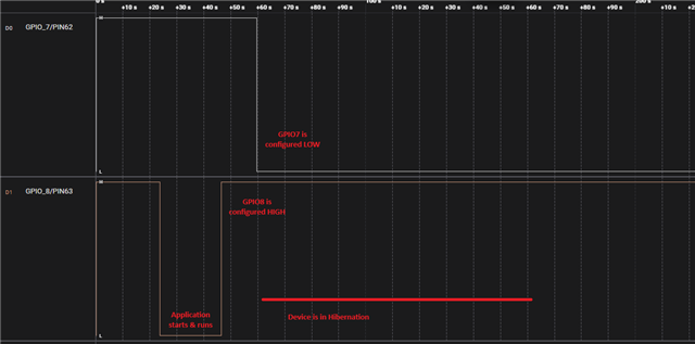

    Can you verify that GPIO8 is staying stable in retention during hibernation? To do this, configure GPIO8 as an output with an internal pull up resistor. This will help to know that the GPIO is stable/configured properly in the hibernation state.
  • Getting GPIO8 to behave reliably during hibernation is the entire issue. If it did, there wouldn't be any problem to solve here.
    What we have seen is that initially, before trying to control GPIO8 during hibernation, GPIO8 would go into hi-z during hibernation causing unpredictable system performance. Then, after changing the firmware to try to control GPIO8 during hibernation (at least to our best understanding), we see no change to the system behavior. Seems like GPIO8 is still going hi-z during hibernation, like we're missing some critical configuration step or something.
  • Yes. I understand that the GPIO8 is not reliably going LOW in hibernation mode. Since, we can't measure the LOW state in hibernation, we wanted to try measuring the GPIO in 'high' state during hibernation. This would give us the validation on the steps you're following to place GPIO. This was the intent for that request.
    Can you share the source code for configuring GPIO8 for hibernation (steps 1 to 4 above)?
  • We can reliably control the state of the GPIO outside of hibernation to drive it high or low, though when actively driven as an output I don't think we would generally enable pull-up or pull-down resistors. We can double-check this to confirm but I don't think the issue has anything to do with GPIO control but more likely has to do with some retention-specific functionality like "retention groups" or how to properly enable retention (as opposed to just hibernating with no retention.)

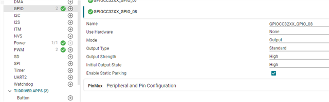

    Can you try 'GPIOCC32XX_CFG_USE_STATIC' for the gpio config?
    In order to 'park' the pin in the state statically defined in PowerCC32XX_config.pinParkDefs[] table, this configuration needs to be defined. Can you please try this and let me know?
  • Yes, I will make that change prior to my test.
  • I don't have that define in our sdk library.  simplelink_cc32xx_sdk_2_40_00_05.
  • You can try 'GPIOCC32XX_USE_STATIC' this define. It looks like it was renamed.
    software-dl.ti.com/.../group___g_p_i_o_c_c32_x_x___pin_config_ids.html
  • Got it, thanks!
  • That did not change the behavior.  The GPIO8 does not stay low during hibernate.

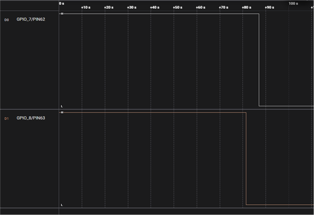

    Can you verify that GPIO8 is staying HIGH in retention during hibernation? To do this, configure GPIO8 as an output with an internal pull up resistor. This will help to know that the GPIO is configured properly in the hibernation state with the steps you're following. As you noted earlier, the impedance of the logic probe influences the output reading, when it is attempted to drive low.
    I confirmed that you're using the correct retention groups for GPIO8. Will discuss this with a HW engineer and follow up as well.

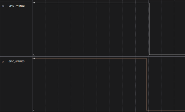

    Sorry, for the late response. I was trying to reproduce this on our side with a CC3235SF launch pad. I'm able to see the behavior with GPIO being configured as an input and driven low. In this scenario, it doesn't look the PIN is driven to low in hibernation.
    But, we can place the GPIO in LOW if we configure the PIN as an output and use the internal pull down resistor.

    2. Open pwmled2.syscfg in CCS (GUI) and open GPIO module
    3. Add GPIO_8 and map it to PIN62 on the header. Configure GPIO_8 as follows
      1. Mode - Output
      2. Output Type - Standard
      3. Output Strength - High
      4. Initial Output State - High
      5. Enable Static Parking - Checked

    But I have one question about your test setup. When you set up GPIO7/8 for low retention and measured them with your logic analyzer, did you add a very weak (~1-10MΩ?) external pull-UP to those pins?
    The logic analyzer itself is going to be ground-referenced, which means simply connecting it to any particular pin effectively adds a weak pull-down to that pin. So regardless of whether retention is working (holding the GPIO low during HIB) or not working (floating the GPIO during HIB), you will see the same result on your scope captures because the scope itself biases the GPIO towards ground.
    I think the only way to prove specifically that retention is working is to very weakly pull the GPIO in the opposite direction of your retention state, and see that during HIB the MCU overcomes this external bias and holds the GPIO in the correct desired state.
  • For earlier measurement, I did NOT have any external pull-UP resistors on those pins.
    BUT, just tried having internal pull up on those GPIOS (GPIO 7 and 8). This is configured via Sysconfig and produces ti_drivers_config.c changes as below (PowerCC32XX_WEAK_PULL_UP_STD). If you look at PowerCC32XX_PIN62, and PowerCC32XX_PIN63 from my last post, you'll see the difference.
    PowerCC32XX_ParkInfo parkInfo[] = {
    /*        PIN                    PARK STATE              Pin Alias
      {PowerCC32XX_PIN01, PowerCC32XX_WEAK_PULL_DOWN_STD},   /* GP10 */
      {PowerCC32XX_PIN02, PowerCC32XX_WEAK_PULL_DOWN_STD},   /* GP11 */
      {PowerCC32XX_PIN03, PowerCC32XX_WEAK_PULL_DOWN_STD},   /* GP12 */
      {PowerCC32XX_PIN04, PowerCC32XX_WEAK_PULL_DOWN_STD},   /* GP13 */
      {PowerCC32XX_PIN05, PowerCC32XX_WEAK_PULL_DOWN_STD},   /* GP14 */
      {PowerCC32XX_PIN06, PowerCC32XX_WEAK_PULL_DOWN_STD},   /* GP15 */
      {PowerCC32XX_PIN07, PowerCC32XX_WEAK_PULL_DOWN_STD},   /* GP16 */
      {PowerCC32XX_PIN08, PowerCC32XX_WEAK_PULL_DOWN_STD},   /* GP17 */
      {PowerCC32XX_PIN13, PowerCC32XX_WEAK_PULL_DOWN_STD},
      {PowerCC32XX_PIN15, PowerCC32XX_WEAK_PULL_DOWN_STD},   /* GP22 */
      {PowerCC32XX_PIN16, PowerCC32XX_WEAK_PULL_DOWN_STD},   /* TDI */
      {PowerCC32XX_PIN17, PowerCC32XX_WEAK_PULL_DOWN_STD},   /* TDO */
      {PowerCC32XX_PIN18, PowerCC32XX_WEAK_PULL_DOWN_STD},   /* GP28 */
      {PowerCC32XX_PIN19, PowerCC32XX_WEAK_PULL_DOWN_STD},   /* TCK */
      {PowerCC32XX_PIN20, PowerCC32XX_WEAK_PULL_DOWN_STD},   /* TMS */
      {PowerCC32XX_PIN21, PowerCC32XX_WEAK_PULL_DOWN_STD},   /* SOP2 */
      {PowerCC32XX_PIN29, PowerCC32XX_WEAK_PULL_DOWN_STD},   /* GP26 */
      {PowerCC32XX_PIN30, PowerCC32XX_WEAK_PULL_DOWN_STD},   /* GP27 */
      {PowerCC32XX_PIN45, PowerCC32XX_WEAK_PULL_DOWN_STD},   /* GP31 */
      {PowerCC32XX_PIN50, PowerCC32XX_WEAK_PULL_DOWN_STD},   /* GP00 */
      {PowerCC32XX_PIN52, PowerCC32XX_WEAK_PULL_DOWN_STD},   /* GP32 */
      {PowerCC32XX_PIN53, PowerCC32XX_WEAK_PULL_DOWN_STD},   /* GP30 */
      {PowerCC32XX_PIN55, PowerCC32XX_WEAK_PULL_UP_STD},   /* GP01 */
      {PowerCC32XX_PIN57, PowerCC32XX_WEAK_PULL_UP_STD},   /* GP02 */
      {PowerCC32XX_PIN58, PowerCC32XX_WEAK_PULL_DOWN_STD},   /* GP03 */
      {PowerCC32XX_PIN59, PowerCC32XX_WEAK_PULL_DOWN_STD},   /* GP04 */
      {PowerCC32XX_PIN60, PowerCC32XX_WEAK_PULL_DOWN_STD},   /* GP05 */
      {PowerCC32XX_PIN61, PowerCC32XX_WEAK_PULL_DOWN_STD},   /* GP06 */
      {PowerCC32XX_PIN62, PowerCC32XX_WEAK_PULL_UP_STD},   /* GP07 */
      {PowerCC32XX_PIN63, PowerCC32XX_WEAK_PULL_UP_STD},   /* GP08 */
      {PowerCC32XX_PIN64, PowerCC32XX_WEAK_PULL_DOWN_STD},   /* GP09 */
    Results are the same. Logic analyzer shows both GPIO 7 and 8 are driven to LOW and kept in LOW in retention state.
    Hope this helps to verify it on your side. Are you able to try this on your side?

  • Hi Alan, CJ,
    I discussed this with our HW engineer and he agreed that the logic analyzer can influence the logic level (LOW) as we're measuring the GPIO. Recommendation was to try a test to drive the GPIO to HIGH in Hibernation and see if the Driver can drive/keep the signal in HIGH state during hibernation.
    From this experiment, first I was seeing that the GPIO was not staying HIGH level in hibernation with internal PULL up only. GPIO8 would temporarily change to HIGH but was driven LOW immediately and in hibernation.
    But, after applying the driver (GPIO_CFG_OUT_HIGH), GPIO8 held in HIGH in hibernation!  See below screen capture. In my experiment, GPIO7 was driven LOW (with internal pull down), but GPIO8 was driven HIGH (with GPIO_CFG_OUT_HIGH) in hibernation.
    Based on this finding, we can reverse the logic levels for your scenario. Can you try the following on your side?
    Update powerShutdown() to have GPIO8 configured as below?
    GPIO_PinConfig gpiocfg = GPIOCC32XX_GPIO_08| GPIO_CFG_OUTPUT_INTERNAL | GPIO_CFG_OUT_LOW | GPIOCC32XX_CFG_USE_STATIC;
    GPIO8 configured as an output for the application.
    Let us know if that helps or not.
