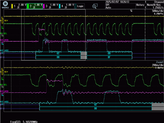

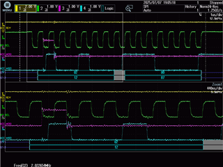

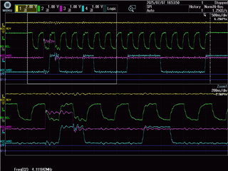

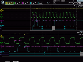

    No communication error has occurred at 4MHz. When I checked the waveforms of SCL and MISO with the oscilloscope, it seemed that they were communicating at a timing that would not be strange if a communication error occurred.
    The waveform of the communication line was collected by the oscilloscope according to the communication speed, and I will send you a screenshot.
    ・ Speeds: 1 MHz, 2 MHz, 3 MHz, 4 MHz, 5 MHz
    Master/Slave: Camera/cc2538
    Communication waveform 2ch: SCL 3ch: MOSI 4ch: MISO (setting 0x12/0x87)
    You can see that the timing is off as the communication speed increases.

    But even if the communication speed increases, the rise/fall timing of the data does not deviate with respect to the rising edge of SCL, and there seems to be sufficient setup/hold time.
    On the other hand, as the communication speed of MISO increases, the rise/fall timing of the data seems to be delayed in relation to the rise of SCL, and the normal value is not read at the rise timing of SCL.
    Especially for the 4MHz and 5MHz waveforms, the rise and fall timing of the MISO is completely off by half a period, so unintended values should be read.

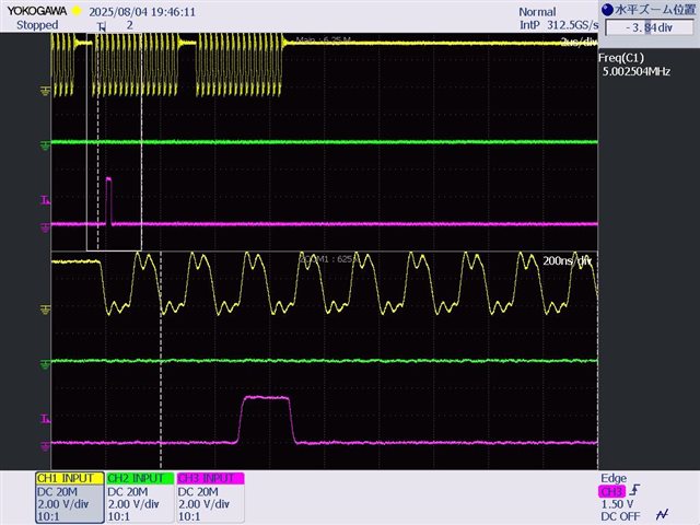

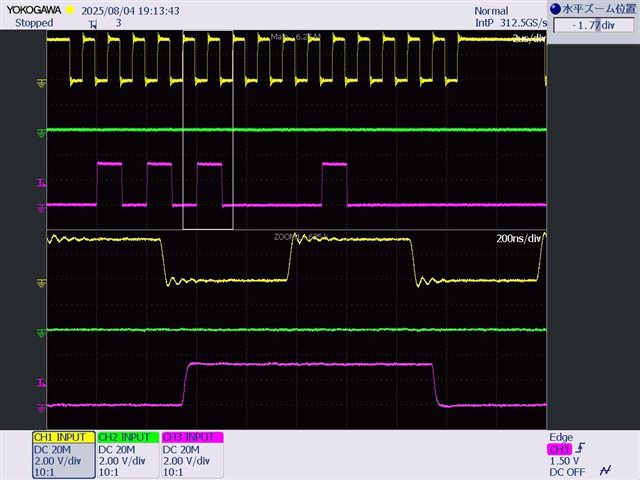

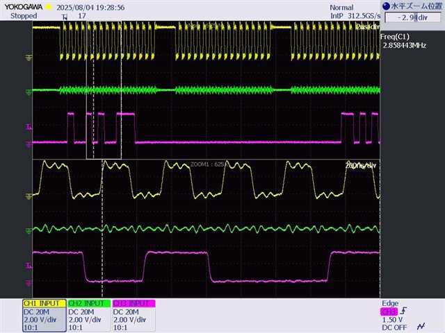

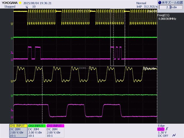

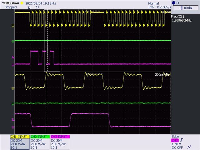

  • Hi Ryan,
    Customer has shared the oscilloscop screenshots on the CC2538 side.
    1 channel (yellow) is CLK and 3 channel (pink) is MISO (CC2538 output signal).
    Since the line is drawn from the housing, there is a ringing of CLK in particular, but from a timing point of view, I think it is not much different from the waveform sent before.
    What do you think ?
    Kenley
  • I think at 5 MHz the CC2538 does not appear to be appropriately changing the MISO line in time relative to the CLK speed.  I don't believe there are any changes from the SPI registers which would affect this.  I don't have the hardware or time with which to recreate this observation.  4 MHz may have to suffice.

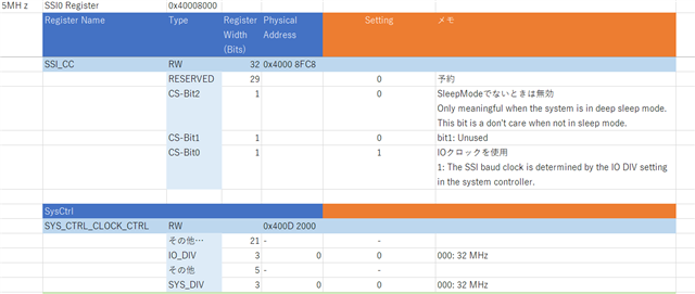

  • The excel sheet shows that the SSI_CC register is using SYS DIV for deep sleep (bit 0) and IO DIV for PIOSC (bit 2).  Have the customer confirm that the SYS_CTRL_CLOCK_CTRL register has IO_DIV and SYS_DIV bits set to 0x0 for a 32 MHz clock.  This is also going to require the OSC bit to select the 32-MHz crystal oscillator (value zero).  If not clear before, the 32 MHz crystal oscillator sourcing the SYS and IO clocks will be a requirement to achieve the highest SPI baud rates.
    Ryan
  • Hi Ryan,
    Let me clarify. I do not really get what you meant.
    Could you please elaborate ?
    Customer's settings for SSI_CC register is using SYS DIV for deep sleep (bit 0) and IO DIV for PIOSC (bit 2) as following.
    And for SYS_CTRL_CLOCK_CTRL register , it is 0 for both IO_DIV and SYS_DIV.
    In this case, what do you mean by the OSC bit is required to select the 32-Mhz crystal oscillator and If not clear before, the 32 MHz crystal oscillator sourcing the SYS and IO clocks will be a requirement to achieve the highest SPI baud rates.?
    Kenley
  • the CC2538 User's Guide states that the system clock or the PIOSC must be at least six times faster than the SSIClk for slave/peripheral SSI modes, and this would be true in the case that 32 MHz divided by six is greater than 5 MHz, however it is not a clean division.
    "The PIOSC is used as the source for the SSIClk when the CS field in the SSI Clock Configuration (SSI_CC) register is configured to 0x1. For master mode, the system clock or the PIOSC must be at least two times faster than the SSIClk. For slave mode, the system clock or the PIOSC must be at least six times faster than the SSIClk."
    It is important to confirm that the SYS/IO clocks, whichever is supplying PIOSC, is not being divided from the original 32 MHz as this is crucial for SPI timing purposes as mentioned in the TRM (as the default value is listed as 0x1).  I apologize as I hadn't realized that those values were already provided at the bottom of the Excel spreadsheet.  I assume OSC is zero as well?  It should be confirmed that 32 MHz is sourcing the SPI, otherwise I don't have additional ideas to share.
    Ryan
  • Hi Ryan,
    The OSC of the SYS_CTRL_clock_CTRL register is set to “0” immediately after startup. So, is there an understanding that the SPI source clock is 32 MHz?
    In addition, because it is in slave mode, 32 MHz / 5 MHz = 6.4 times, which is more than 6 times.
    Kenley
