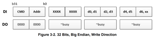

2. Cmd, Addr
• The detailed format of CMD and Addr is unclear.
• In the above documentation, Addr appears to be 16 bits, but in the sample project, it appears to be 17 bits.
• The list of CMDs is unclear.
• The specifications for Addr are unclear (does the value of Addr depend on the CMD?).
3. Protocol Structure
・Does the above Protocol Structure correspond to the data section (d0, d1, ... d6, xx) in Figure 3-2?
・The specifications for SYNC are unclear (size, fixed value, but the specific value)
・The specifications for Opecode are unclear (size, list of Opecodes)
・The format appears to differ from the sample project. We would like to know the correct specifications.

    2. CMD, ADDR: there are 3 values possible for the ADDR, 0xBFF0, 0xBFF8 and 0xBFFC. 0xBFFC is for reading the status register and it is triggered every time the host get an interrupt from the chip. In return the interrupt would get de-asserted. 0xBFF0 is used whenever the host wants to send/receive something (command/data) and 0xBFF8 is triggered right after the 0xBFFC to read more data from the shared memory (since core register is not carrying much information). These can be found under nab.h header file. You can also find the format of these 4 bytes under bus_spi.h header file. The division is not 2 bytes each, it is just a rough division. Address is 17 bites, CMD is 12 bits and all the rest you can find on the header file.
      I agree that CMD is misleading here, it is not actual command but a combination of flags and 12 bits of length.
      It will be fixed for next revision.
    3. yes, the rest goes into what the picture shows as d0, d1, ...
      SYNC values can be found in nab.h header as HOST_SYNC_PATTERN and DEVICE_SYNC_PATTERN. You will see HOST_SYNC_PATTERN when the host transmits to the chip and DEVICE_SYNC_PATTERN on the other direction.
      Opcodes can be found in Command_e under osprey_public_commands.h header. it is 2 bytes long.
