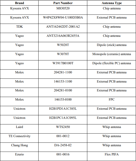

CC3351MOD is certified with 17 antennas. The Antenna List is as such:
