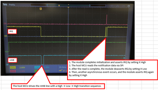

  • Dear Santhosh,
    Thank you for your response.
    Please find attached a waveform capture showing the IRQ and nHIB behavior during initialization.
    After closing jumper J8, the IRQ pin indeed goes High, and the waveform seems to show correct transitions. The current jumper configuration on the BOOSTXL-CC3135 board is as follows:
    • J2: 1–2 (VBAT_CC)
    • J3, J4, J5: 2–3 (Pulled Down)
    • J7: 2–3 (VCCLDO)
    • J8: Closed
    The IRQ pin (CC_IRQ) is monitored and appears to behave as expected in the waveform. However, despite this, the return value of the following API call:
    _i32 role = sl_Start(NULL, NULL, NULL);
    is still ROLE_UNKNOWN (1), even though the device seems to be operating in AP mode (SSID "mysimplelink-xxxxxx" is visible on the PC).
    Is there any condition under which sl_Start() would return ROLE_UNKNOWN, even if the device is in fact operating in AP mode?
    Also, just to confirm:
    Is it correct to understand that the IRQ line is considered “asserted” when it is High?
    Any further insights would be greatly appreciated.
    Shuichi Marutani

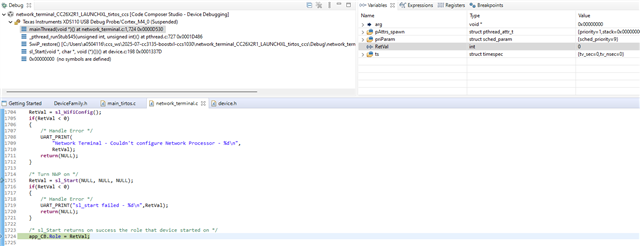

    sl_Start(NULL, NULL, NULL) in step 1 should return a successful code. What is the application you're using?
    Can you run network_terminal application from the SDK plugin? Do you see successful behavior or same as what you see?
    In my set up, I'm able to see that sl_Start() returns '0' for the first call.
    Which MCU are you using with CC3135 booster pack? For my set up, I'm using CC26X2R1 launchpad.

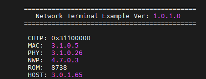

    Can you share the versions that you see when you run network_terminal application? Below are the versions from my board:

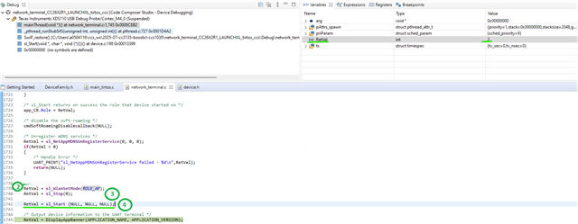

    Tried to reproduce your scenario with network_terminal application by modifying it. I'm able to see that sl_Start() returning ROLE_AP (2). See below screenshot.
    Santhosh
