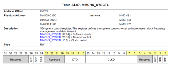

According to dm3730 datasheet , I can change the sdio clock frequence base on following
But actually,the sdio clock frequence always keep on 96MHz not 48MHz even write "0xe0087" to 480B412C(MMCHS_SYSCTL)
The above value should set the CLKD=2 and the out put clock frequence should be devide by CLKD

    Anyway, The 96MHz is OMAP master clock. It's always 96MHz. In order to change the clock for the MMC you need to calculate the divisor (96MHz/clockrate) you want. Shift it by 6 to set the CLKD, also enable ICE and DTO. Without turning on the ICE the clock won't change.
    Don't modify any other bits on the SYSCTL register.
