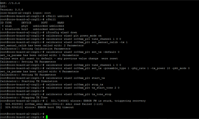

On a board using the CC3351 we encounter the following behavior:
I can send tone for any channel that I want using the command (calibrator wlan0 cc33xx_plt tx_start_tone 2 0) but I cannot send continuous packets in the air using the command calibrator wlan0 cc33xx_plt start_tx after setting all the required parameter.
Can you describe how to send continious packets?
