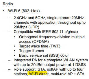

I am trying to create a peer-to-peer connection with the LP-EM-CC35X1 development board. Does this hardware support Wi-Fi Direct? If not, what alternative P2P Wi-Fi methods are recommended for this platform?
  • Hi Serkan,
    Yes, this device supports WI-FI direct.
    From the datasheet (page 1):
