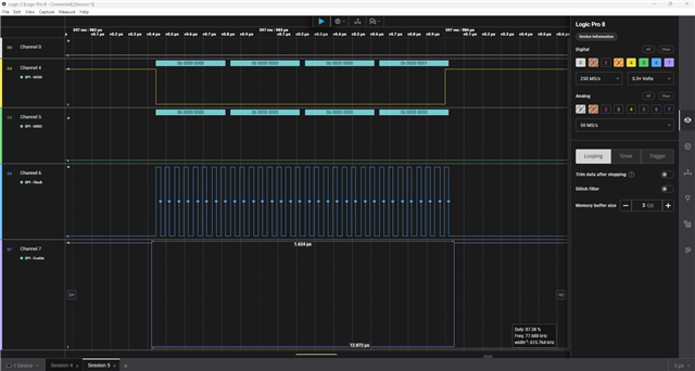

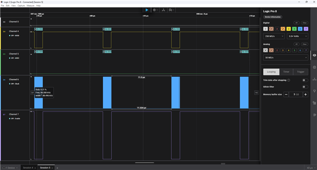

    I'm currently still debugging a test I'm running where I try to maximize throughput of SPI transactions on the CC3220SF, taking inspiration from the SYSCFG settings mentioned in this other thread. I'm editing the SPI Controller example where I use a logic analyzer to probe MOSI, CLK, and CSN (EN) lines and set up the spicontroller.c file to essentially ignore the peripheral device completely. I change the bit rate to the maximum (2e7) and the data size to 32. This yields a 11us latency between transactions as seen in the screenshots below without using DMA. I am also looking into the DMA channels associated with the SPI transactions to see if I can optimize better.
