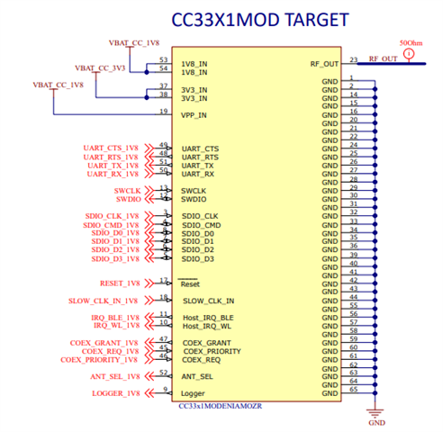

How are we supposed to connected the "VPP_IN - 1.8V OTP programming input supply" in the field, meaning after assembly of our end product?
What is VPP_IN used for precisely?

Hey Michael,
This supply will need to be connected always as illustrated in the reference design from the datasheet:
