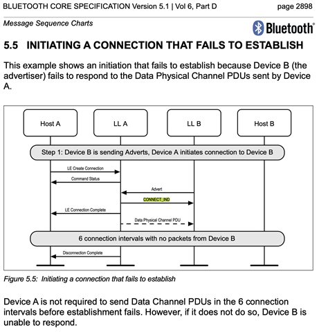

  • Hi, as additional context, we are experiencing the lengthy connections due to excessive failure rates when initiating connections as Central to our bespoke BLE Peripheral. The symptom we see as the Host side of HCI is the 0x3e "Connection Failed to be Established" condition immediately following initial Link Layer attempt:
    Using an iOS stack with nRF Connect for our peripheral, we have nearly 100% successful link establishment (i.e. our first HCI command—LE Read Remote Features—succeeds).
    We observed a similar condition with our other Central role device that uses a different vendor's controller and we were able to resolve the issue by tuning its airtime prioritization parameter. That controller's firmware has separate flags for prioritizing each of BLE connection, initiation, scanning, and advertising over WLAN activities. The BLE initialization flag is the one that helped our application the most in curing this symptom.
    I notice from SWRU423A Sec 8.4.1 Table 24 there is testing for BLE activities' effect on WLAN throughput, which is important to our application (our BLE throughput is minimal). Our concern is getting the WL1831 firmware to dynamically prioritize receiving BLE PDUs in the first six connection intervals after we initiate a BLE link, in order to successfully connect.
    If TI has vendor commands or tools for adjusting this behavior, then we can explicitly request the prioritization ourselves when we want BLE connection prioritization. Please advise.

  • Thank you! One more detail that directed our investigation towards Wi-Fi/BLE coexistence: dis-associating our device (which is Wi-Fi STA + BLE Central) from AP significantly improves the success rate of getting the LE Remote Features response without a 0x3e disconnection.
