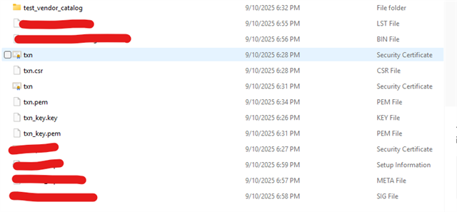

    Private Key and Certificate Generation:
    * openssl genrsa -out txn_key.key 2048
    * openssl req -new -sha256 -key txn_key.key -out txn.csr (be sure to fill out the details being asked for, especially the org name which I made match with my certificate names - txn in this case)
    * openssl x509 -req -sha256 -days 365 -in txn.csr -signkey txn_key.key -out txn.crt
    * openssl x509 -in txn.crt -outform der -out txn.der (make sure the .der extension is what you are storing in your catalog)
    * openssl rsa -in txn_key.key -outform pem -out txn_key.pem
    * openssl x509 -in txn.crt -outform pem -out txn.pem
    By now, I have something like this:

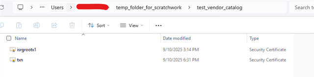

    Recall that the certificates in my catalog folder are in .der format.
    Generating Catalog and OTP Files:

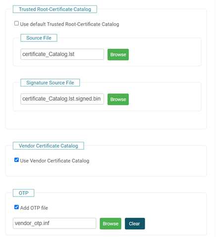

    1. Catalog + OTP Files
      "%IC%" tools make_cert_catalog --cert_folder "%ROOT%\test_vendor_catalog" --out_file "%ROOT%\certificate_Catalog.lst"
    "%IC%" tools sign --file "%ROOT%\certificate_Catalog.lst" --priv "%ROOT%\inno_key.pem" --out_file "%ROOT%\certificate_Catalog.lst.signed.bin" --fmt BINARY_SHA1
    "%IC%" tools meta --cert "%ROOT%\inno.pem" --out_file "%ROOT%\vendor_otp.meta" --mac 000000000000
    "%IC%" tools sign --file "%ROOT%\vendor_otp.meta" --priv "%ROOT%\inno_key.pem" --out_file "%ROOT%\vendor_otp.meta.sig" --fmt BINARY_SHA1
    "%IC%" tools inf --algo 1 --sign1 "%ROOT%\vendor_otp.meta.sig" --meta "%ROOT%\vendor_otp.meta" --out_file "%ROOT%\vendor_otp.inf"

    In UniFlash Advanced view, I attached the .bin together with its .sig.
    For the “certificate file name,” where your example used txn.der, I added my inno.der.
