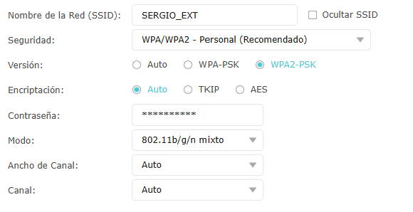

CC3351: Failure to associate with a TP-LINK TL-WA850RE Wi-Fi repeater
Part Number: CC3351
The device fails to connect to the TP-LINK TL-WA850RE Wi-Fi extender during association:
The association procedure appears to proceed correctly, but after transmitting the key in frame No. 391 (see below), the CC3351 requests deauthentication with code 1 (unspecified reason).
The firmware version is cc33xx_rtos_mcu_package_R7_2 (Using SDIO)
Note: Based on empirical testing, the CC3351 exhibits frequent association failures with Wi-Fi networks and is incompatible with roughly 20% of the routers evaluated.
Sergio

  • Hi Shlomi
    Apparently, the error is in frame 2482 of the attached capture:
    2482 14.269006 CC3351 86 ERROR! Current Association Request Includes HE/VHT IE while wifi6 is disabled!
    The configuration file is the one included with firmware version 7_2, and I’ve attached the decoding performed using the configuration tool.
    What steps should I follow to enable Wi-Fi 6?
    Regards.
    Sergio

    The TL-WA850RE extender is in my office, and my PC and phone are usually connected to it without any issues.
    Attached is a screenshot of the TL-WA850RE configuration web page:
    Regards.
    Sergio
    captura TL-WA850RE.zip
  • Hi Shlomi.
    I’ve found that if WPA2 encryption is set to AES only (not automatic TKIP/AES), the CC3351 connects to the network without issues. Perhaps, and this is just speculation, the CC3351 chooses TKIP (which isn’t supported in the CC3351 firmware and therefore fails), even though AES is available as an option.
    If this is true, it might be one of the reasons why it fails to work with approximately 20% of the routers/APs I’m testing. This kind of automatic TKIP/AES configuration (even though TKIP is not safe and not supported by newer routers) is very common in these types of routers/APs, which are among the best-selling ones in Argentina.
    Regards.
    Sergio
