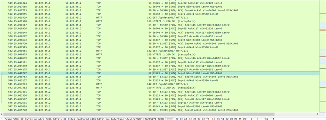

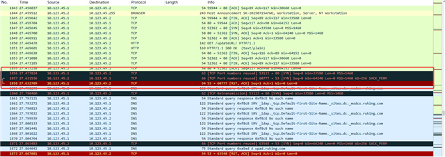

CC3235MODASF: CC3235MODASF:When the CC3235 operates in AP mode as a client and sends a GET request, it encounters a Socket Error Error! code = -111, Description = GETTask: connect failed
Part Number: CC3235MODASF
Dear TI FAE  Engineer
When the CC3235 operates in AP mode as a client and sends a GET request, it encounters a Socket Error Error! code = -111, Description = GETTask: connect failed.We look forward to your prompt response as the project is extremely urgent.Below is the code for httpget.c:

  •  Thank you for your advice of Wireshark. And I haven't disabled firewall. Based on the Wireshark logs, does this indicate that the firewall is blocking DNS queries? Additionally, the server port is 80, but the client port for 10.123.45.1 (CC3235) keeps changing. Is this normal, or am I missing a relevant configuration? If it's possible to set a fixed port, is there a related process for doing so?
    That source port for TCP connection is changing is pretty normal. You don't need to change this. Actually this is way which allows proper function of NAT (if its used at network).
    Your PC (.2) is asking of your CC32xx (.1) for resolving some DNS address. And because CC32xx not knows the answer you response it that.
    Issue with SYN is likely your PC server is not responding. Why? I don't know.

  • The image shows the normal operating state. Could the issue be that I didn't disable the firewall, causing the cc32xx to terminate connection requests?
    Hard to say. But if firewall is enabled incoming connections (SYS packets) are dropped at firewall.
    Jan
  • Hi Aodong,
    Connection refusal (code -111) can definitely be caused by your firewall. Someone in another thread had a similar issue, but they were trying connect to an IPv6 address, maybe it can help you. Here is the thread.
